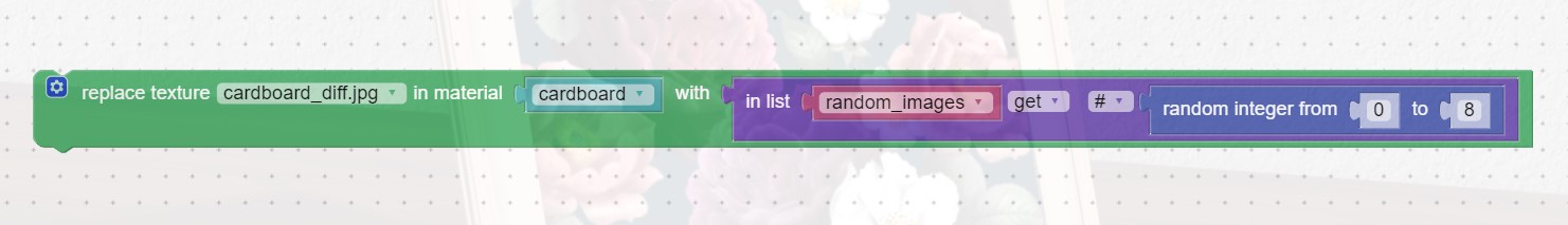

    #15413
    Anonymous
    Inactive
    it is not working in my test, i use “custom_image” project for that. I removed puzzles which refer to social buttons and URL load. Did it screw that project on some way? The screenshot shows complete puzzles. I didn’t touch init settings and alert.
    #15416
    So what’s happening when you click on the picture? Can you share some browser’s consol screenshot.

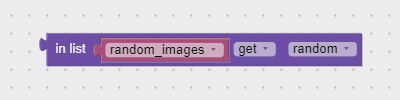

    #15419
    you can also use a bit simpler variant of the “in list” puzzle:
