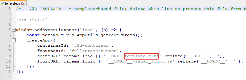

    what am I missing?
    In your_app_name.js type in the new name.
    #66987
    vision
    thank you, it works!

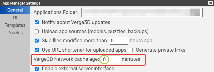

    I can’t find a browser on the Quest 2 that will delete cache history
    Actually, by default, any browser receives cached content from Verge3D Network. That’s a server-side feature.
    The new version may load eventually, but it takes at least several minutes
    You are free to get rid of these “several minutes” (15 by default)

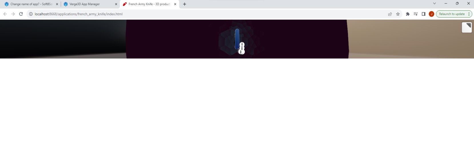

    Hello !
    I have followed everything but only the verge3d part works fine. I chynaged the css html and js but here is the result.. Any idea ?
    Thank you
    #68421
    You didn’t renamed .css inside .html. See the video from 1:40.
