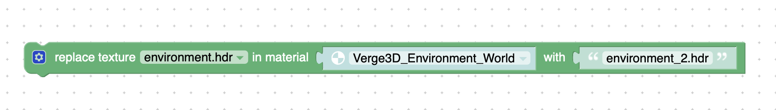

Based on the recent discussion inthis thread –I have a question,
is it possible to change HDR background used in scene with interaction? So change of lighting mood whole scene can be changed upon different different interactions & conditions.Note –
I am not asking of changing material of an object ( such as the “ground” in scooter example).
I am asking direct background HDRI change over interaction. is it possible with puzzles?-

Alexander KovelenovStaffHi,
This is quite easy. You can use the “replace texture” puzzle on the world material to swap existing HDR to another:
