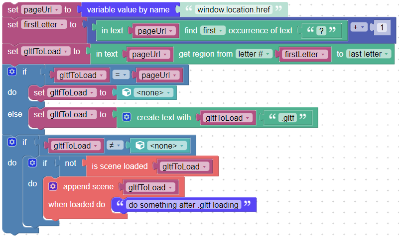

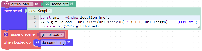

.../index.html–>.../index.html?table, then read these names and append corresponding scenes.Puzzles and JS coding. Fast and expensive.

ParticipantWhat I want now is when user click suppose table 4, this verge 3d interface will open with table4.gltf loaded in it and when user clicks table 7, this verge 3d interface will open with table7.gltf loaded in it
Well, that’s exactly what was offered above )))
…/Test.html – appends nothing
…/Test.html?cube – appends cube.gltf
…/Test.html?farmer – appends farmer.gltfShow you links that lead to a different tables…
2022-07-26 at 9:02 am #544032022-07-26 at 9:21 am #54404kdv
ParticipantYou can use puzzles only to create logic, without scripting… You can use
#instead of?. The result will be the same.
Test.html is the default .html, created by the App manager. You can see it in the browser console…Also, index.html has preloader which leads to verge3d interface after loading.
If the loader and v3d interface urls are different then you should read the loader url, find .gltf name in it and append this name to the v3d interface url…
