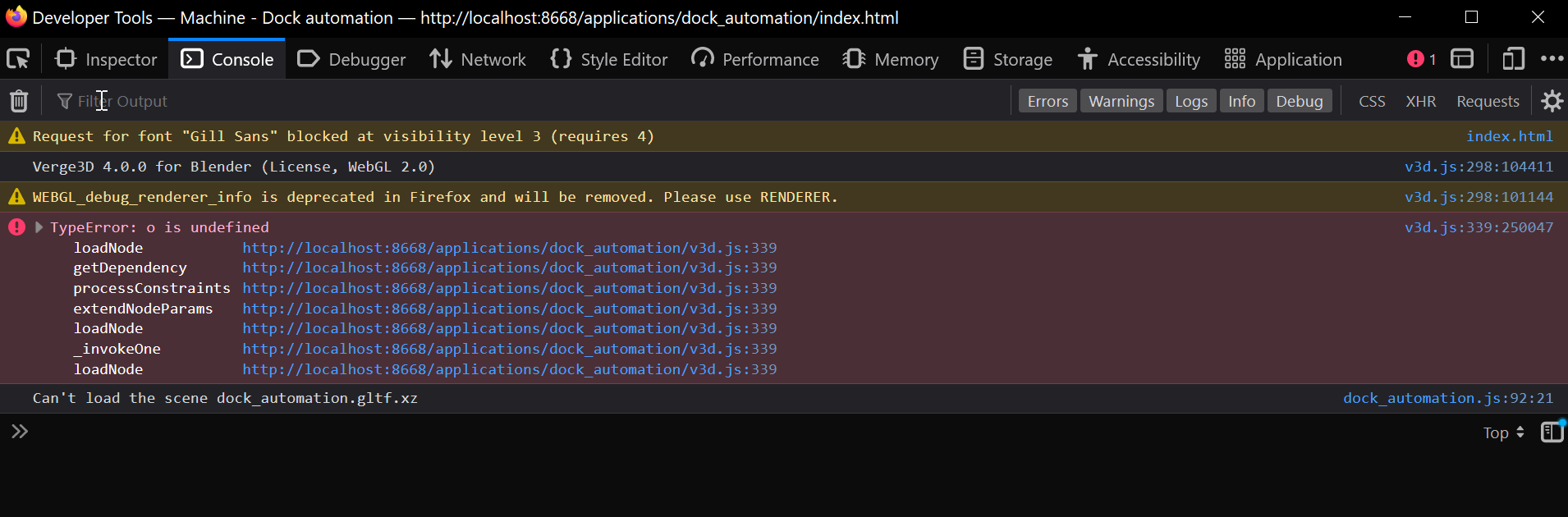

    Hi Devs,
    I haven’t been able to get this verge app to work after updating the files to version 4.0.0. This is the error I get in the console. Any ideas how to fix it ? :scratch:
    PS – I tried to re-export the app in blender and still nothing

    If you test in Chrome does it give the same error?
    #53216
    Please share the scene (or part of it) that crashes. We’ll try to figure out what’s happening.

    #53258
    samuraijkm
    Hi Xeon,
    Chrome doesn’t work either.
    #53259
    samuraijkm
    Hi Alexander,
    I unpacked the images and 7 zipped the file. See attached.
    #53313
    It was an issue with constraints with missing targets. Going to fix it in the upcoming Verge3D 4.0.1 scheduled in a few days.

    #53393
    Fixed!
