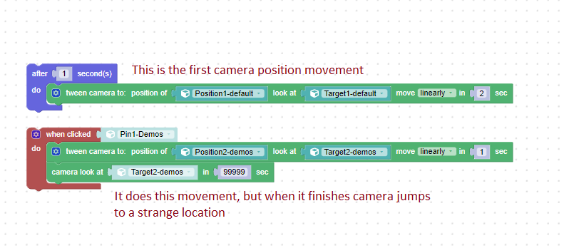

    Hello, I have a strange camera bug that I couldn’t figure out.
    – When I click an object in the scene I want to move the camera to a position and look at a direction, stay there without any camera controls. Simple as that.
    – I have only one camera in the scene. I have two empties. one for location and one for direction.
    – When object is clicked, it does the camera movement but then camera jumps to a strange location.
    Any suggestions?

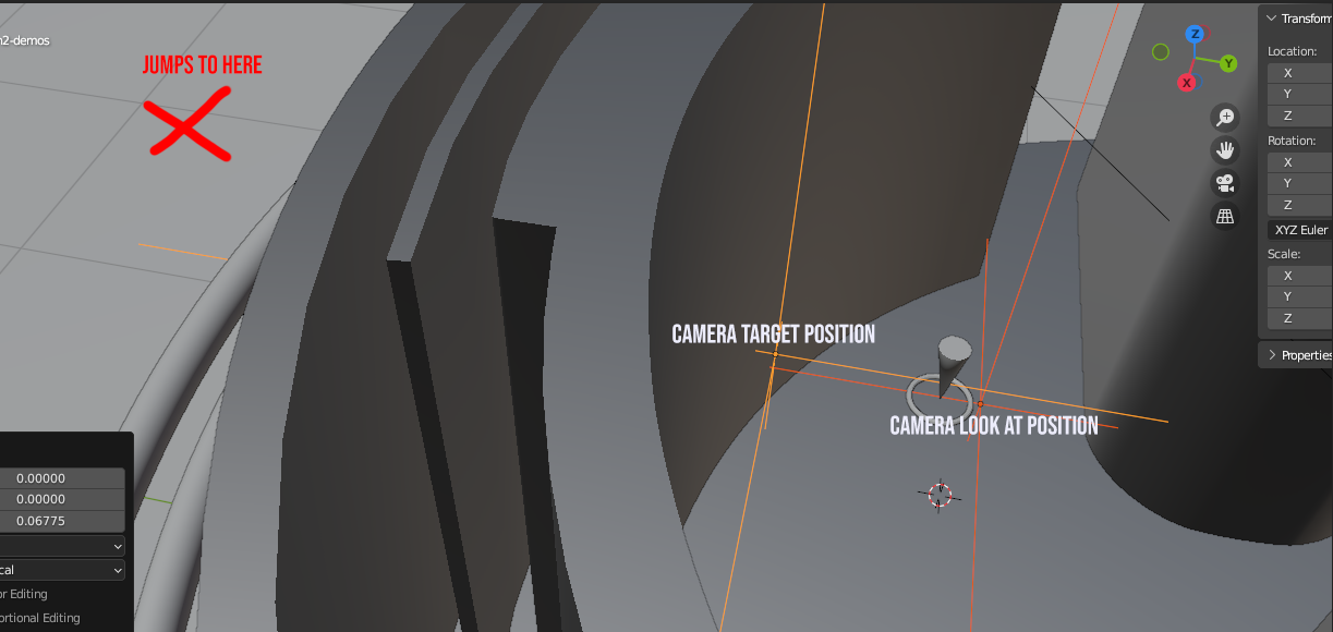

    Here how it happens:
    – When object is clicked camera moves as expected
    – But when the movement is finishes, it jumps out somewhere else.

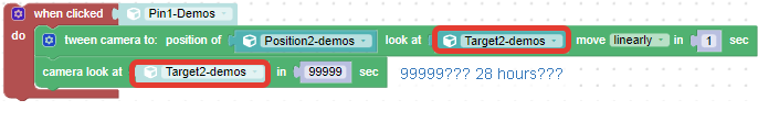

    #59425
    1. is it really necessary to look at the same object twice? Once is not enough?
    the camera look at puzzle is a private case of the tween camera puzzle, without a position changing. remove it. your camera is already looking at the target.

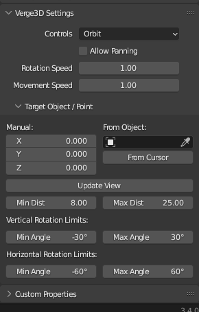

    2. the distance between the new camera position and the look at point is less then 8 meters. that’s why the camera jumps back.
    #59433
    tonec
    Oh thank you, I was not even aware of that!
    And yes there is no need to camera look at, I was just trying =)
    You saved my day!
