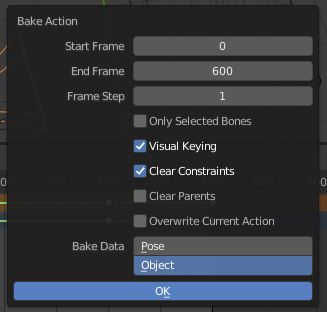

    Just in case someone else needs the information:
    You have to select the camera, then go to Object > Animation > Bake Action
    Then check: Visual Keying and Clear Constrains.
