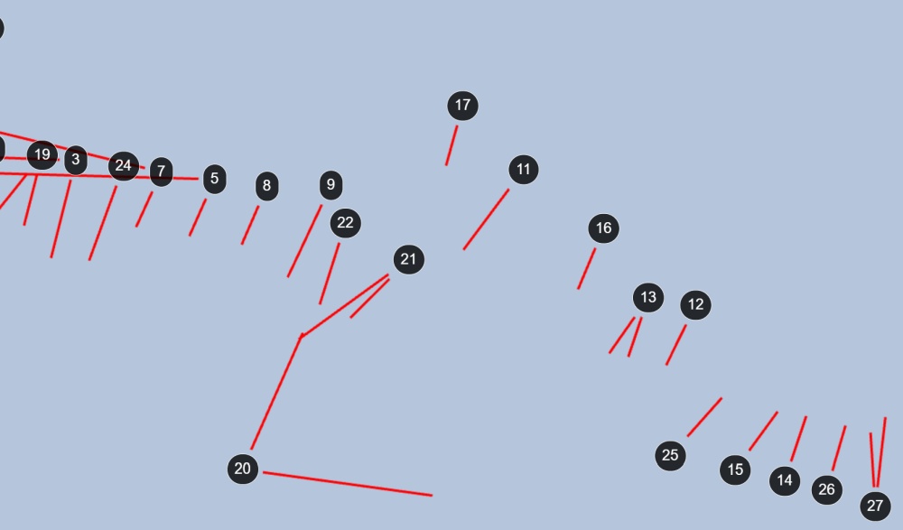

visualizerParticipantHi
As attached in the image one of my small project is having several call outs.
the puzzle editor every time becomes too huge to handle this quantity of call outs. It is also time consuming to add and remove them. its a tedious task.
Is there a trick or any easy way to manage this quickly & smoothly?The ref2.jpg shows the 1/4th of the call outs I set in puzzle editor. So you can understand how tedious it is.

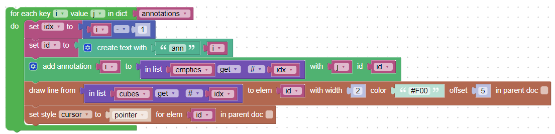

My concern is about automating and simplifying the task.2024-02-13 at 12:46 pm #70468kdv
ParticipantUse lists or dictionary, loops and procedures with arguments.
2024-02-13 at 3:07 pm #70515
visualizerParticipantUse lists or dictionary, loops and procedures with arguments.
Haha ! 6 inches above my head.
Looks like lot of headache. lol2024-02-13 at 3:37 pm #70541kdv
ParticipantYour puzzles are already headache for you. Learn to optimize them. What I see on the screenshot can be reduced to one dictionary, one loop and one small procedure…

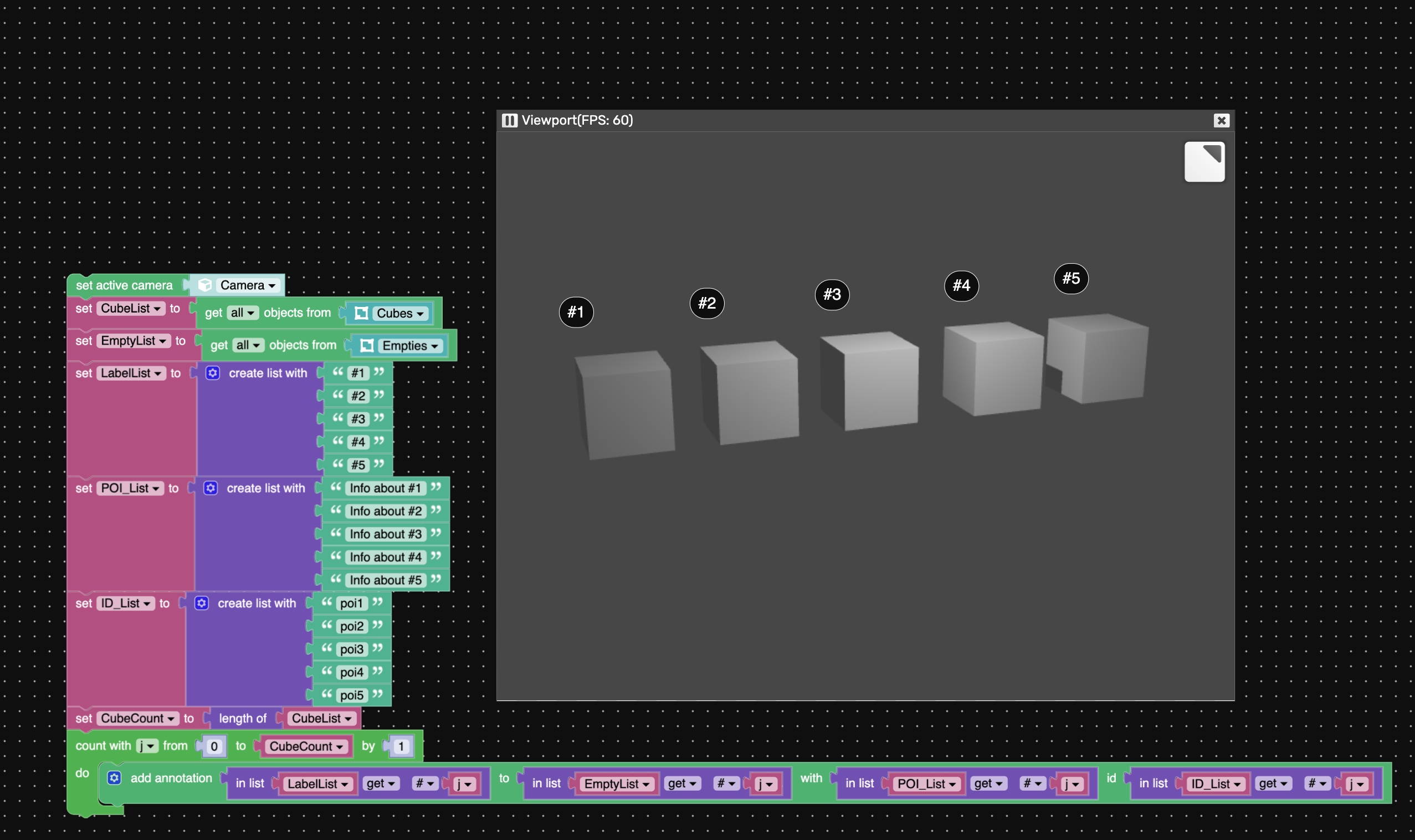

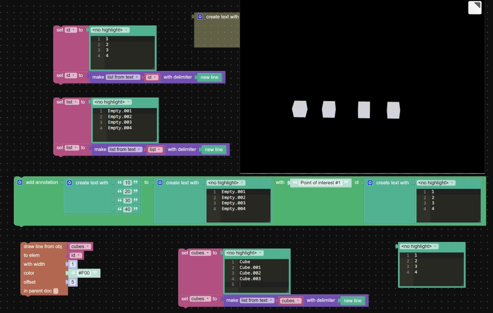

visualizerParticipantTechnically it looks difficult or impossible to me, because there are unique steps to be performed per object.
like create annotation with unique number & id
then draw a line from specific object to that idBut still I spent some time playing with this setup… Does that make any sense to anyone of you?

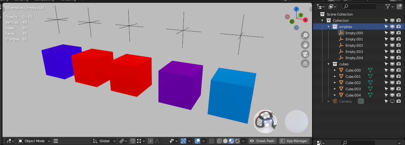

Can you correct this to work if it is logically ok? just wondering.There are four cubes & four empties above them I tried to create this logical structure for generating multiple call outs. Of course it is not working
2024-02-13 at 5:30 pm #70549
visualizerParticipantYes Xeon Agreed !
So I just sent my little crude workout above.2024-02-13 at 5:31 pm #70550

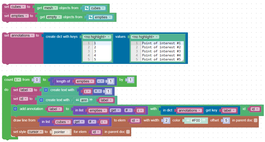

2024-02-13 at 9:21 pm #70556
xeonCustomerLots of options…to create lists.
I created a similar solution.Attachments:
Tutorials - https://www.xeons3dlab.com2024-02-14 at 4:34 pm #70640
visualizerParticipantYes! looks a different setup approach.
My setup also should work with some tricks and trial tests I believe. I will try playing around.
