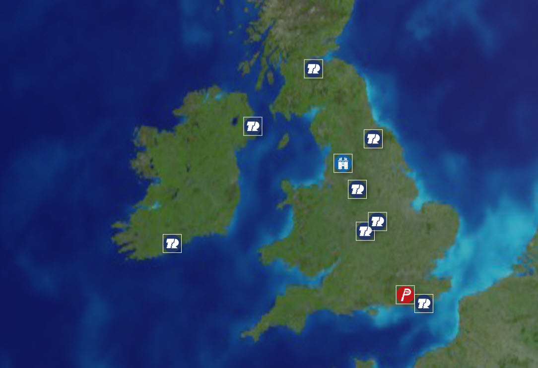

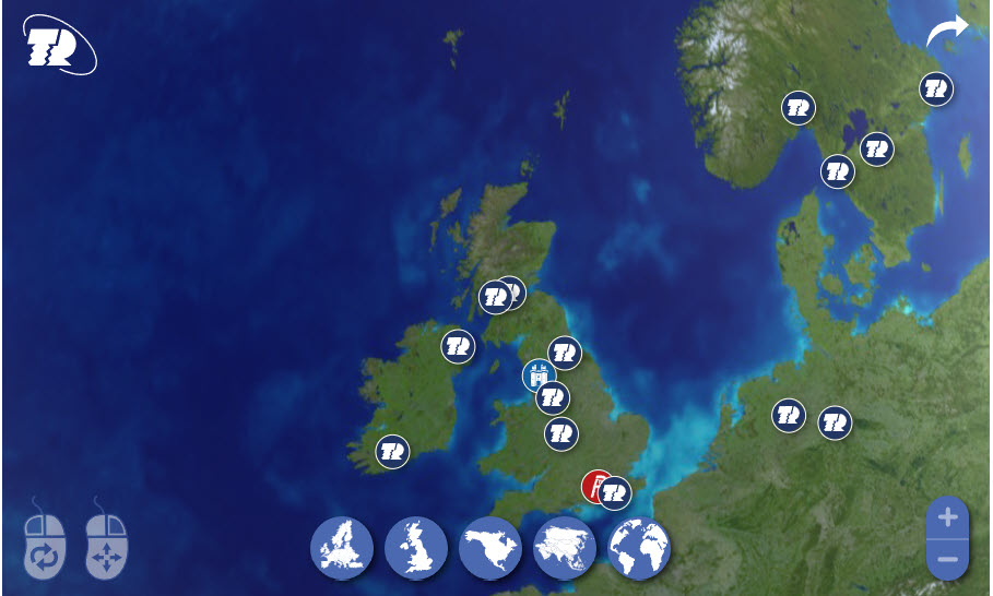

    Hi there, the visual appearance of the outline on my map buttons has changed from a circular outline to square after updating verge to the latest version. I haven’t done anything else to the files other than update the application within the app manager. Please advise how I can restore circular outlines.

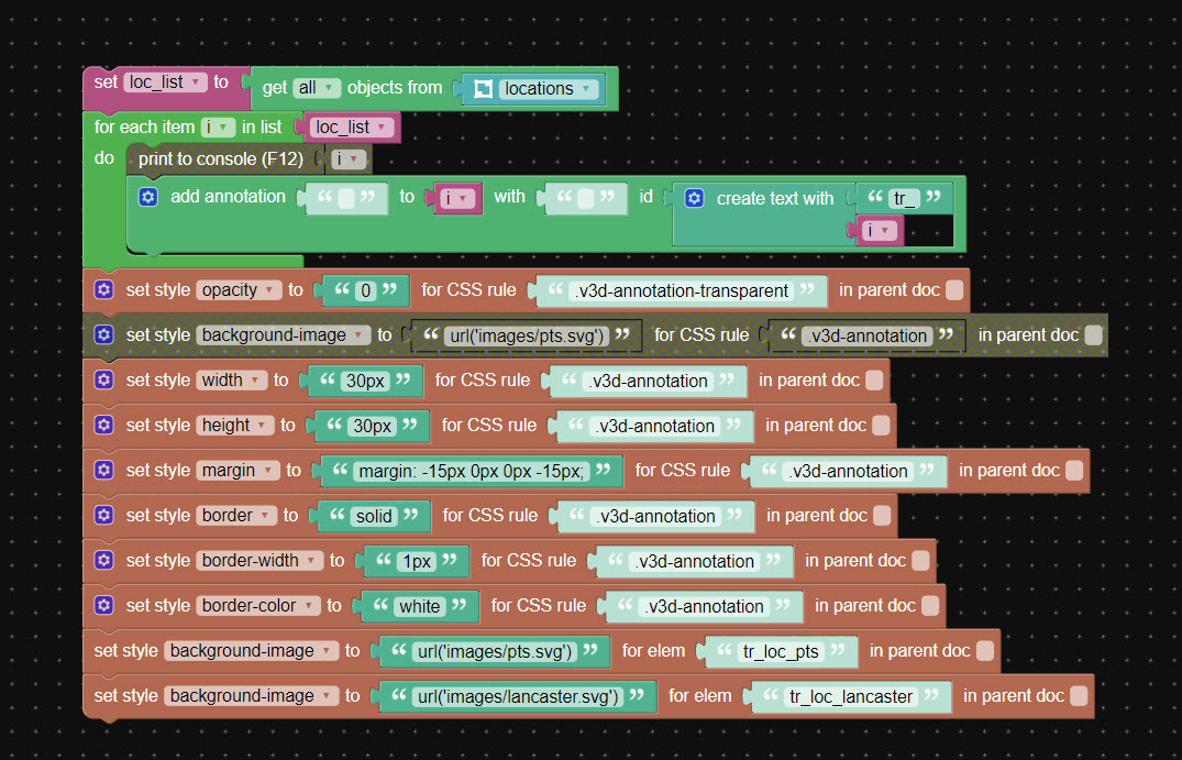

    I think this has to do with the transparent background svg, it appears that the border and mouseover states no longer respect the transparency of the image
    #69020
    Anjanita
    ok, its not an annotation though, unfortunately I didnt write the puzzles for this so fixing them is a bit problematic – the button style is set here setting the opacity to 0 and the boarder to 1pc but now doesn’t seem to recognise the transparent part of the svg its referring to?
    #69022
    Anjanita
    Ignore me – you meant in the css not in the puzzles, i removed and all working now
