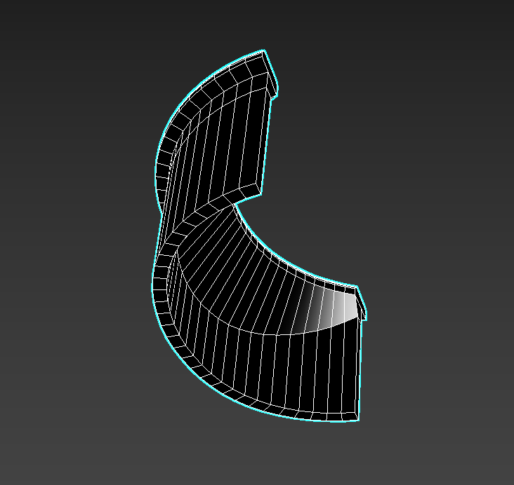

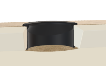

    Hello there,
    I’m facing an annoying behavior.
    Is that bug or some camera parameter i should use ?
    Please look at the spall video / pictures.
    The black object is thin, but not flat.
    Any idea, for some camera “clipping” or sort of parameter ?
    #60752
    it’s a z-fighting. Remove faces under that black faces, or try to increase near clippimng of the caera and decrease far clipping of he camera.
    #60753
    NaxosCG
    Thanks.
    I’ve found that the wood faces are not really behind the black part, but “inside” the black volume, so for sure too close to the front black faces.
