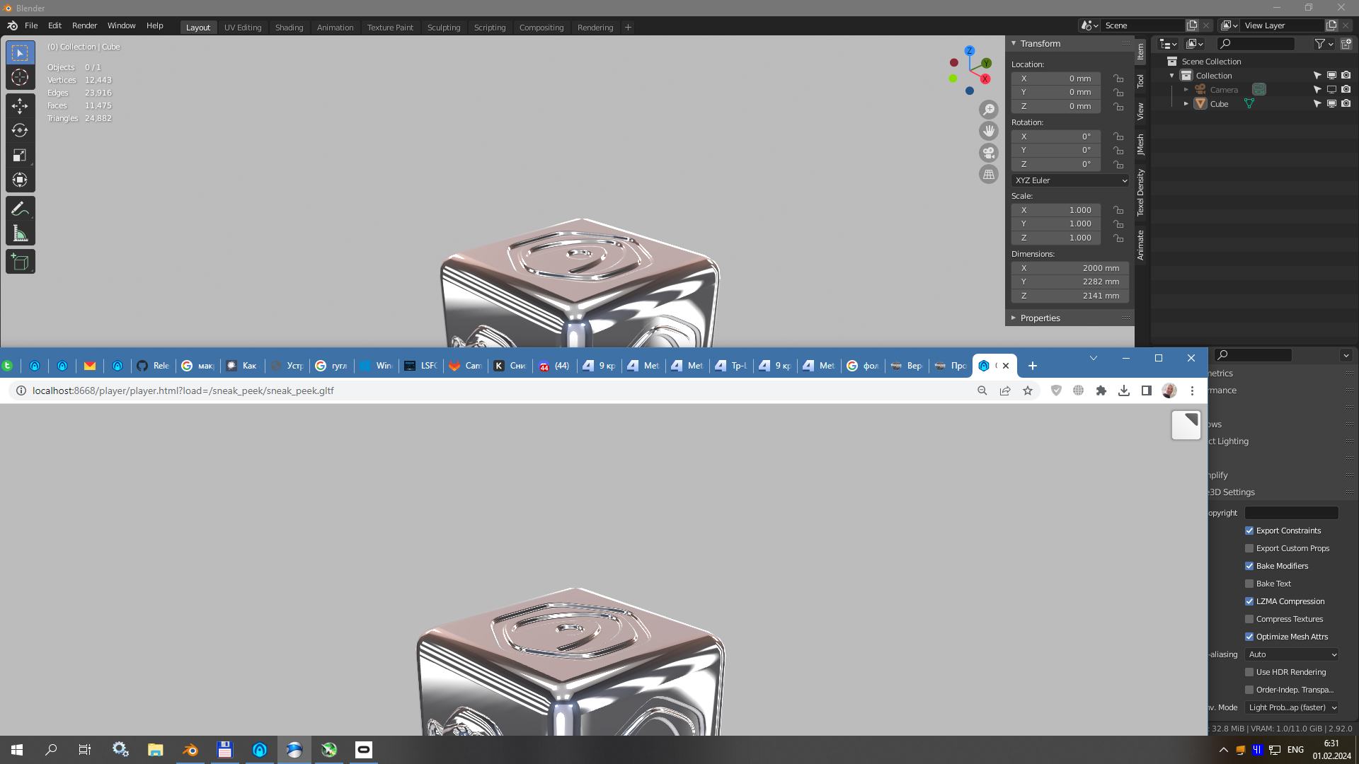

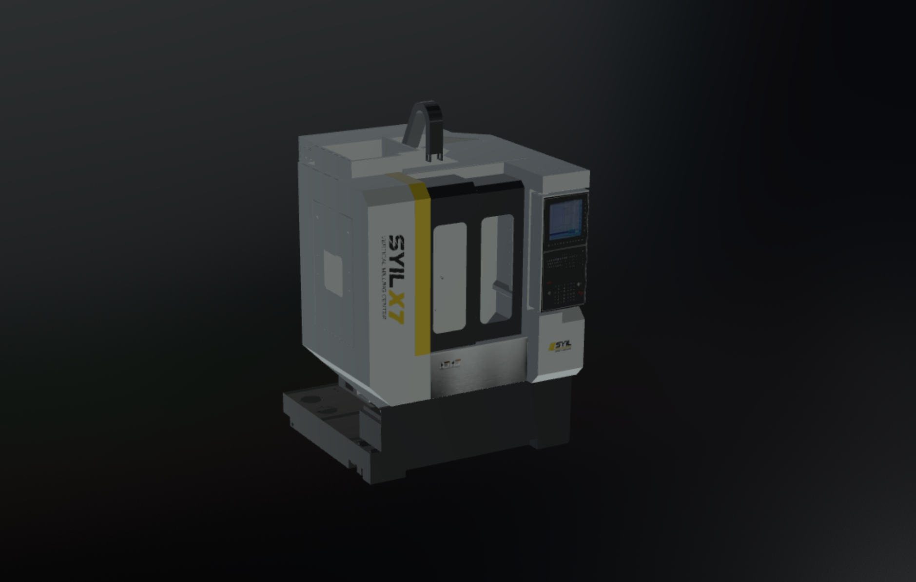

CustomerI’ve been messing with this as long as I’ve been using Verge. Why does the Blender preview not match the Verge 3d simulation? I’ve tried everything and nothing I do makes the two look the same. It’s very frustrating. Any input would be very appreciated.
2024-02-01 at 2:27 am #70062kdv
ParticipantFirst, show screenshots to see what you are talking about.
On my side I see no difference
2024-02-01 at 2:56 am #70064vergecurious
CustomerThanks for your reply. Attached are screen dumps. The brighter one is on blender. The other one is on verge.

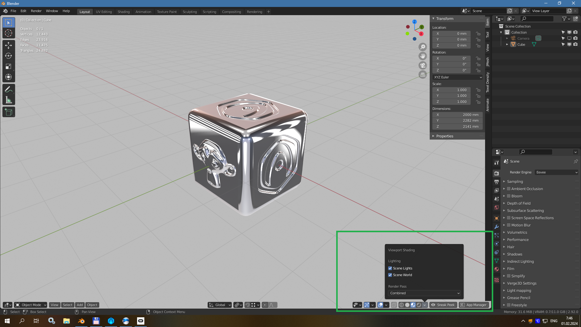

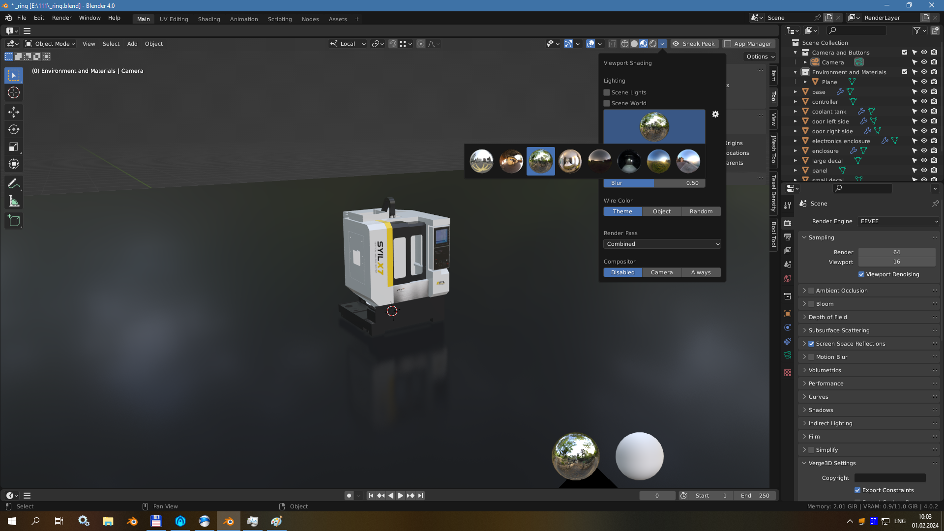

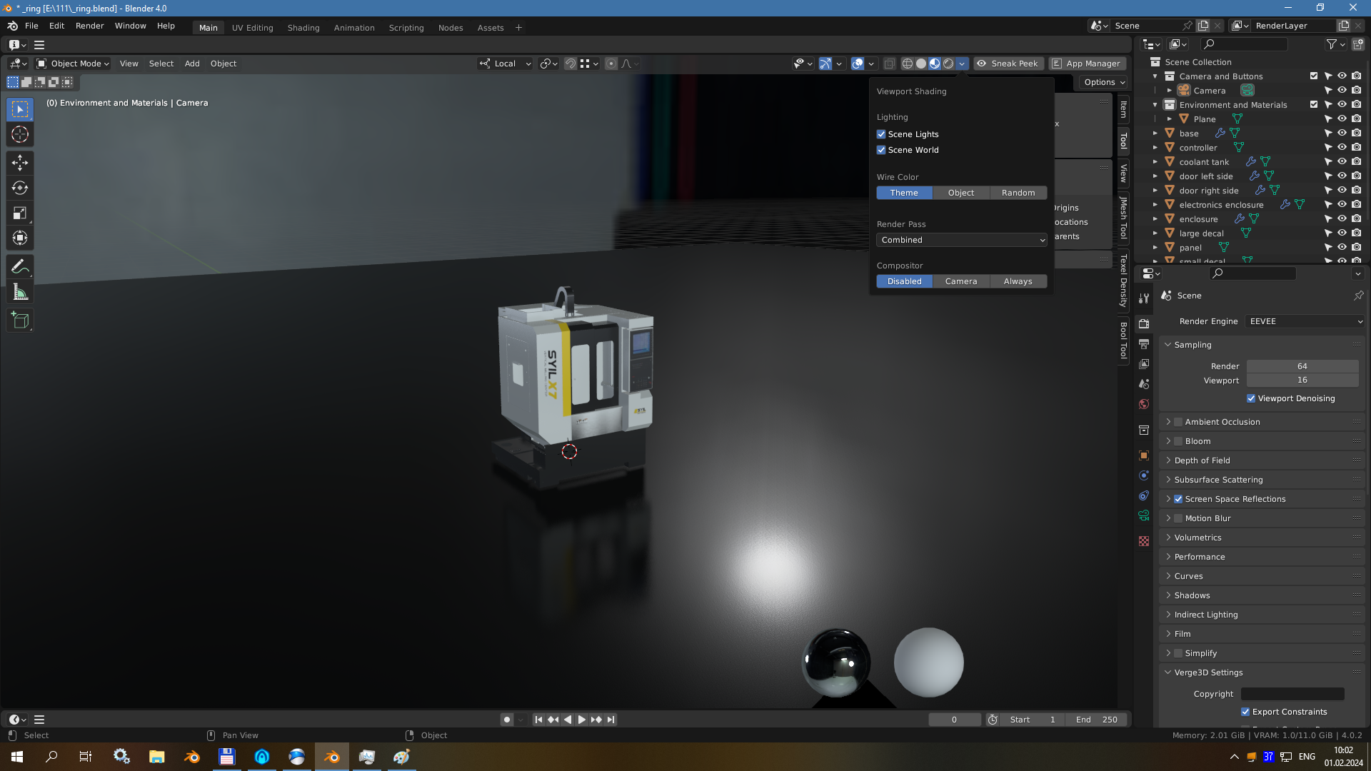

2024-02-01 at 3:49 am #70067kdv
ParticipantMost likely you are using different lightings. Show the world material shader in Blender. Also show these options in your Blender
Or just attach your .blend file here. It will be the fastest way.
2024-02-01 at 4:02 am #70069vergecurious
CustomerNope, same items selected. But my version has three additonal options, disabled, camera and always. “disabled” is selected.

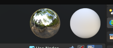

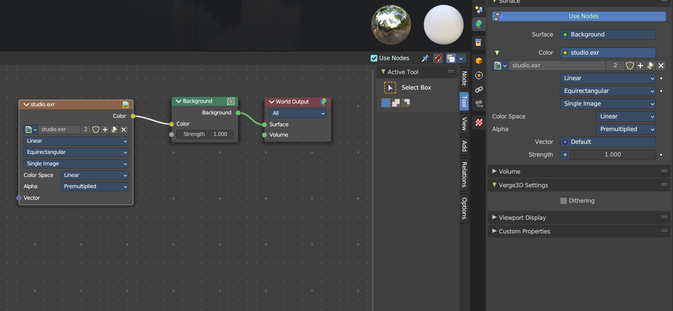

2024-02-01 at 4:20 am #70071kdv
ParticipantUse .hdr instead of .exr. But if you’re insisting on using .exr then change
Color Spaceto Non-Color.Found
studio.exrin Blender’s folder. See no difference withNon-Color. WithLinearVerge3D renders brighter than Blender.So, share your file to find out what’s wrong with it…
Are you sure? I see that your are using one of the built-in maps in Blender.

2024-02-01 at 5:50 am #70075vergecurious
CustomerI fixed it using a downloaded hdr file. Thanks for sending me in the right direction. Here you think you are doing the right thing using a file in blender. Again, thanks for your help. Been dealing with this forever.
2024-02-01 at 6:04 am #70076kdv
ParticipantAs expected, you’re using one of the built-in EXR maps. They work in Blender only.
You should use the world material shader in Blender to see what you get in Verge3D. Lighting MUST be the same both in Blender and in Verge3D.
