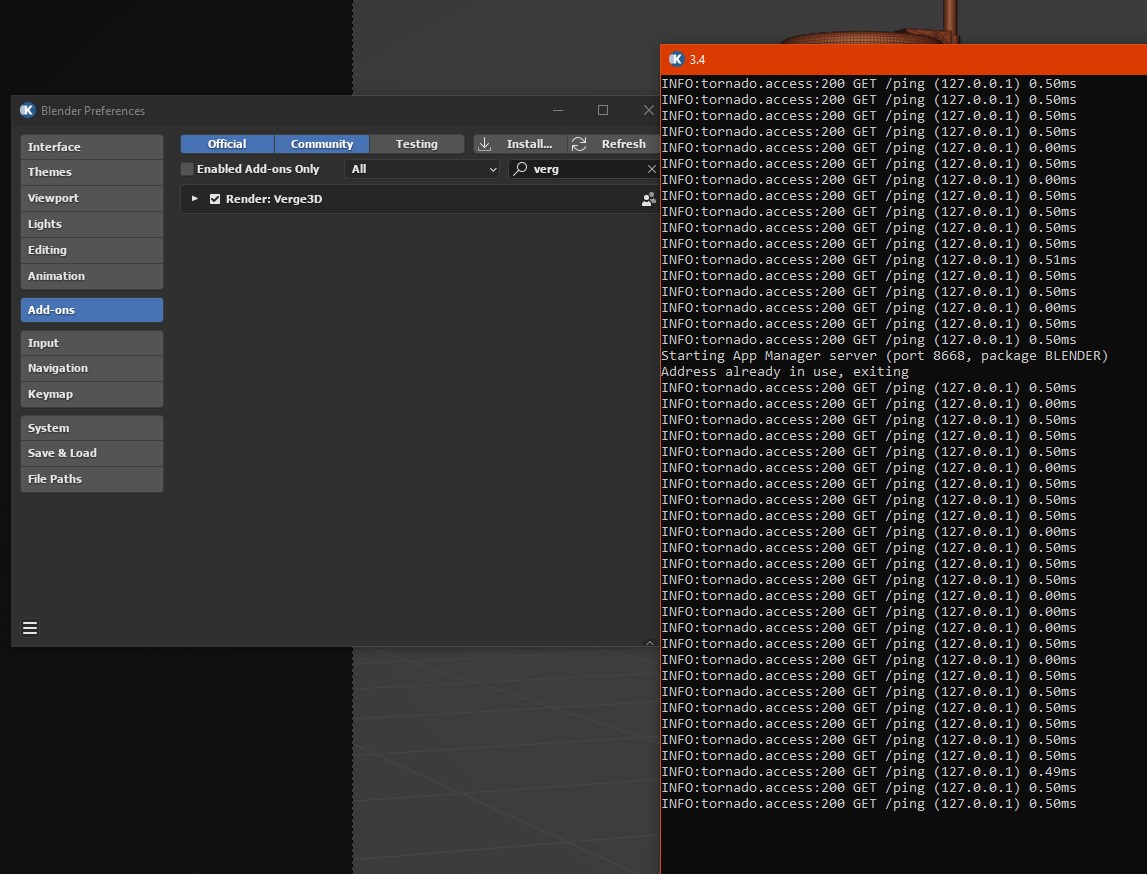

    Hello, with the new 4.2 version Blender creates this message repeatedly
    INFO:tornado.access:200 GET /ping (127.0.0.1) 0.50ms
    until Blender freezes. Only when the Verge 3D addon is disabled, the message stops and Bender keeps working. I have attached a screenshot also. Thank you!

    Its K-Cycles in Windows 10, but I had no problem before installing 4.2.
    Version of K-Cycles is the same as when it was working.
    I will make you a video with the bug, as I enable the addon and it starts, but its as you see in the picture. Empty startup file that freezes shortly after the addon is enabled
    #60107
    Hi, we introduced more communications between Blender and App Manager in 4.2. Perhaps it somehow conflicts with K-Cycles. Please reach them out and report this issue.
