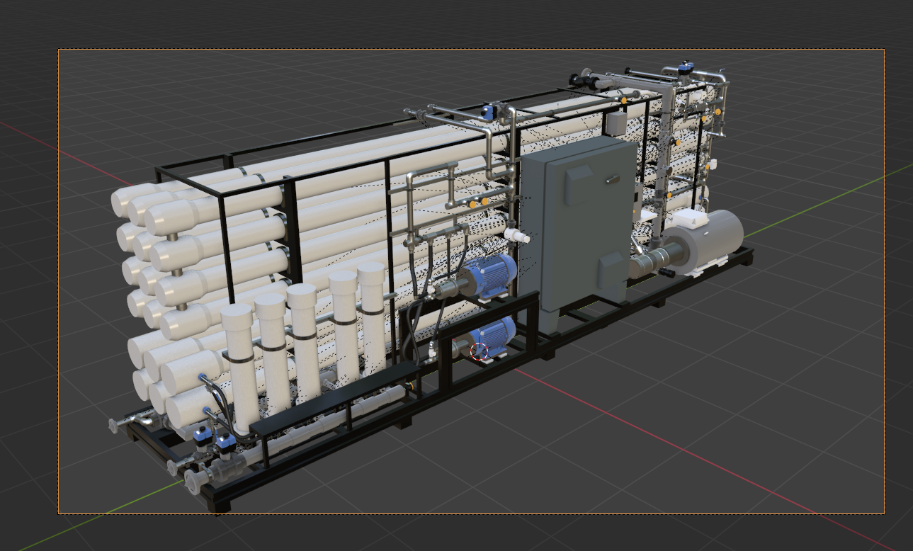

    This is the Cam Perspective view in Blender:

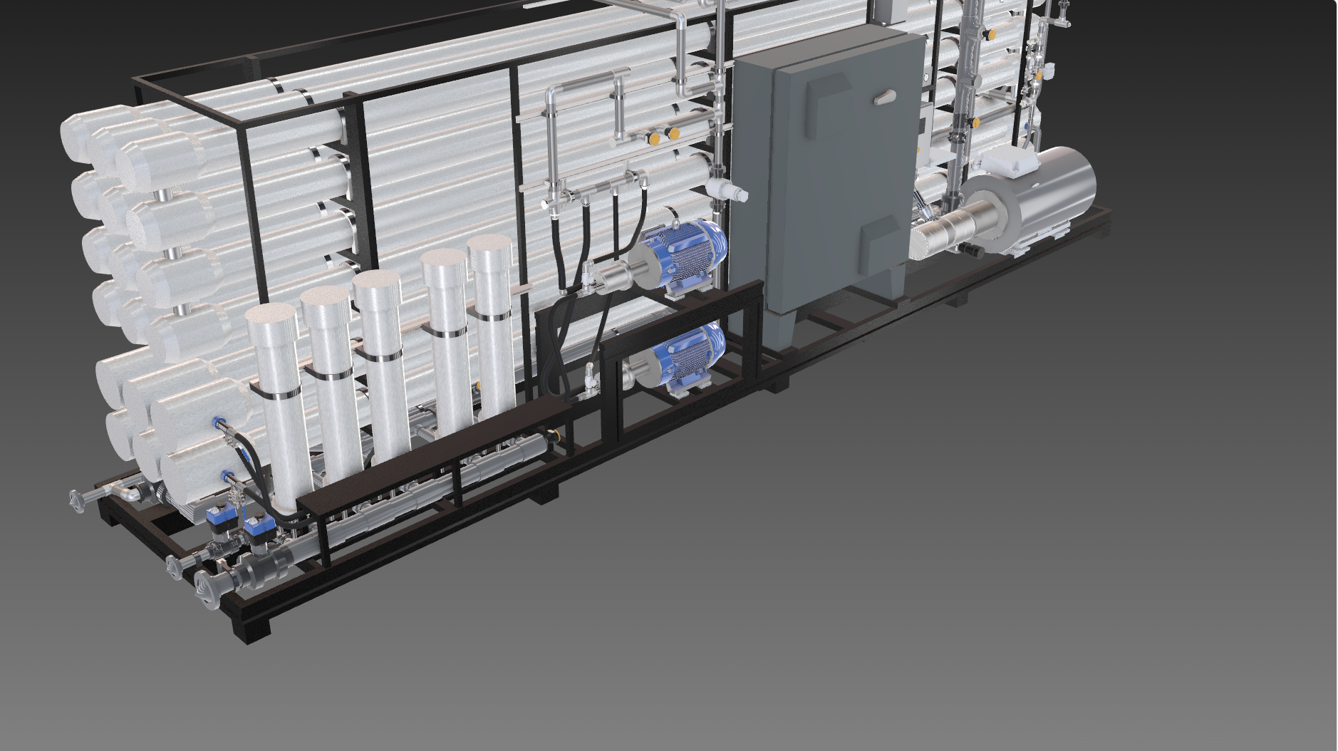

    This is what the app shows in the browser:
    Why can account for this discrepancy?

    Your camera is looking exactly at 0,0,0 point and this point is right in the middle of your screenshot. That’s the camera’s orbit point and it’s alwayas in the middle of the screen. Just add an offset in the camera settings.

    My camera is not looking exactly at 0,0,0 until I publish it, the issue is, that I have moved my camera to where I want it, but Verge3D resets it to looking exactly at 0,0,0 for some reason, how do I get it to stop that?
    Thanks.

    I appreciate that, but why doesn’t Verge3D simply avoid resetting my camera coordinates when I compile the scene?
    Why would it reset instead of framing the scene exactly as I set it according to the Active Scene Camera view in Blender?
    Thanks.

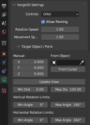

    #80991
    c4cc
    set offsets or choose a target object
    Pardon the stupid question, but how do we set offset? I don’t see it in that screenshot
    #80993
    :unsure:
