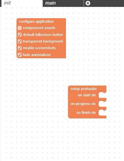

If I use the transparent background option then I get a black background in screenshots and full-screen options. If I disable transparent background then it makes background black during the preloader (loading). Do you guys know why it is happening like this and what is the solution for this? Thanks.
2020-12-27 at 4:15 am #36895Yuri KovelenovStaffget a black background in screenshots and full-screen options.
For screenshots, you should turn on the option “enable screenshots”
https://www.soft8soft.com/docs/manual/en/puzzles/Initialization.html#configure_application2020-12-27 at 4:34 am #36900arslankhanCustomerIts already enabled.
2020-12-27 at 4:36 am #36901arslankhanCustomerbut still not working

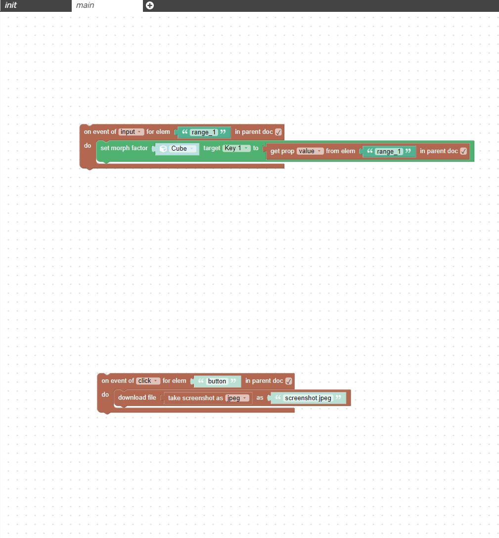

2020-12-27 at 4:38 am #36902Yuri KovelenovStaff2020-12-27 at 5:06 am #36903arslankhanCustomerI just created a test case for you. Please check the following link:
https://cdn.soft8soft.com/AROAJSY2GOEHMOFUVPIOE:e9e9354811/applications/ok/index.html
I have also attached my puzzle screenshots.
check the full-screen button it will change the background to black. I have also added the button to take screenshots but it’s not working at the moment.
Thanks in advance.Attachments:
You must be logged in to view attached files.2020-12-27 at 5:12 am #36906arslankhanCustomerNow if I disable transparent background, it will show a black screen while loading because of preloader puzzle

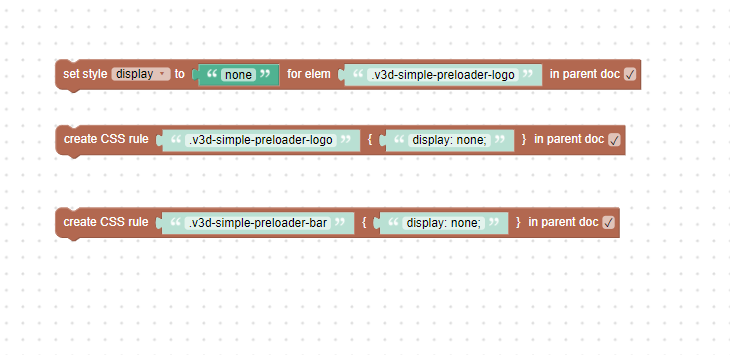

2020-12-30 at 5:33 am #36953arslankhanCustomerThanks @Mikhail for this solution, I am looking for same solution.
I have tried to change the css style Display to none for .v3d-simple-preloader-logo and .v3d-simple-preloader-bar, but it did not work for me.
Can you please guide me how can I achieve this. I have attached photo of my puzzles used for this task. Thanks.Attachments:
You must be logged in to view attached files.2020-12-30 at 5:58 am #36955Mikhail LuzyaninStaffYou do not need to create this CSS rule it’s already exist and you do not need to check in parent doc checkbox.
