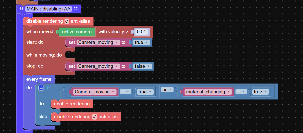

    I wonder if since years there would be a new AA solution to make it really nice, even on small devices (smartphones, older pcs), and even with heavy meshes.
    For now i’m using some brute force “enable rendering / disable +AA” solution, it works on my rtx4090, but flickers black in other systems.
    See attached screenshot to understand : it checks 2 variables on each frame, very brute force.
    You guess that the AA on export from max is not good enough, specially in horizontal meshes.
    Any idea ?
    Ideally, i’d like to have no AA, then, after some not-moving / not changing material delay (1-2 seconds, forex.), it comes AA

    Sounds interesting, but can i set that using puzzles ?
    Sorry, i’m a 3D guy, not a code one.

    It works great !
    Of course, on smaller PC, it goes from 60fps to 45 at level 2, but so much nicer !
    Many thanks !
    I’ve tried to enable / disable it regardless camera is moving / material is changing, but as my puzzle for this is “every frame” based, it does not work well.
