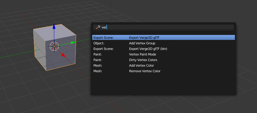

    #1950
    but wondering is there a button that simply update the GLTF and took me to browser while working in Blender?
    Well, a possible solution can be that you hit the space key and search for Verge3D and do export. It remembers your search, so next time you can just hit Space-Enter-Enter and your glTF updates. In the browser, keep your app running so you need just press F5 on your keyboard to reload it. Finally, use Alt-Tab to quickly switch between Blender and the browser. B-)
