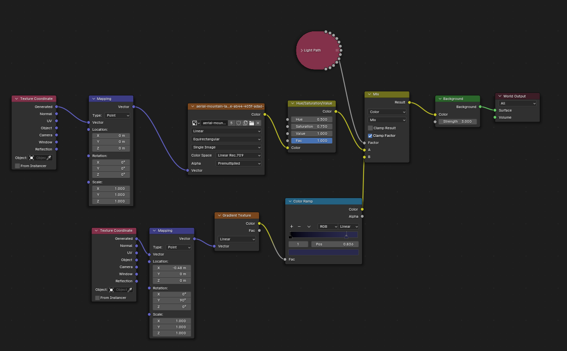

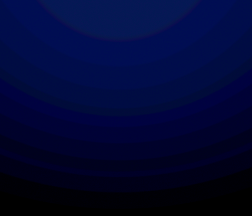

    I am encountering banding artifacts despite enabling dithering. The dithering happens in the world material and looks like the attached image. I have enabled dithering in the world settings.
    The material setup is also attached.

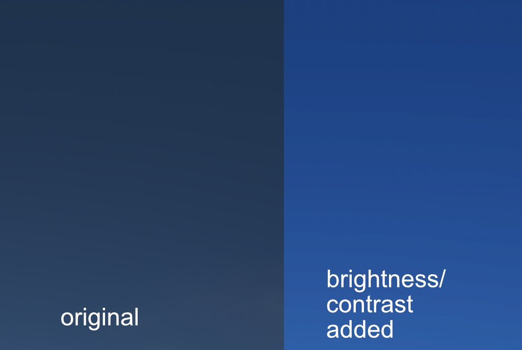

    I have taken a look at the project and it appears the be the source image that is causing the problem. It has the gradient banding already in the image as default. You can take the image into your favorite image editor and boost the brighness and contrast to really see where the issues are in the image.
    You can solve this using your photo editor and smoothing out the colors or finding an image with less banding.
    You can also see this in Blenders Viewport by turning off the Light Path going into the Mix Node and looking in the positive Z direction.
    I think you will be pleased once you smooth those banding artifacts in the image.

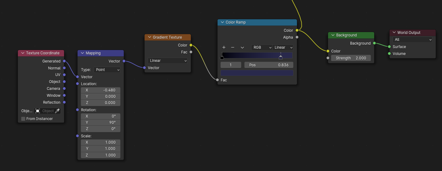

    Thanks for looking at it Xeon! Though I find that odd. Why would the source image’s banding have anything to do with the gradient texture? What’s shown should only be the gradient texture.
    As a proof one can completely remove the HDRI image and just use the gradient in the background shader. Same banding happens. That makes me think this is independent of the HDRI used.
