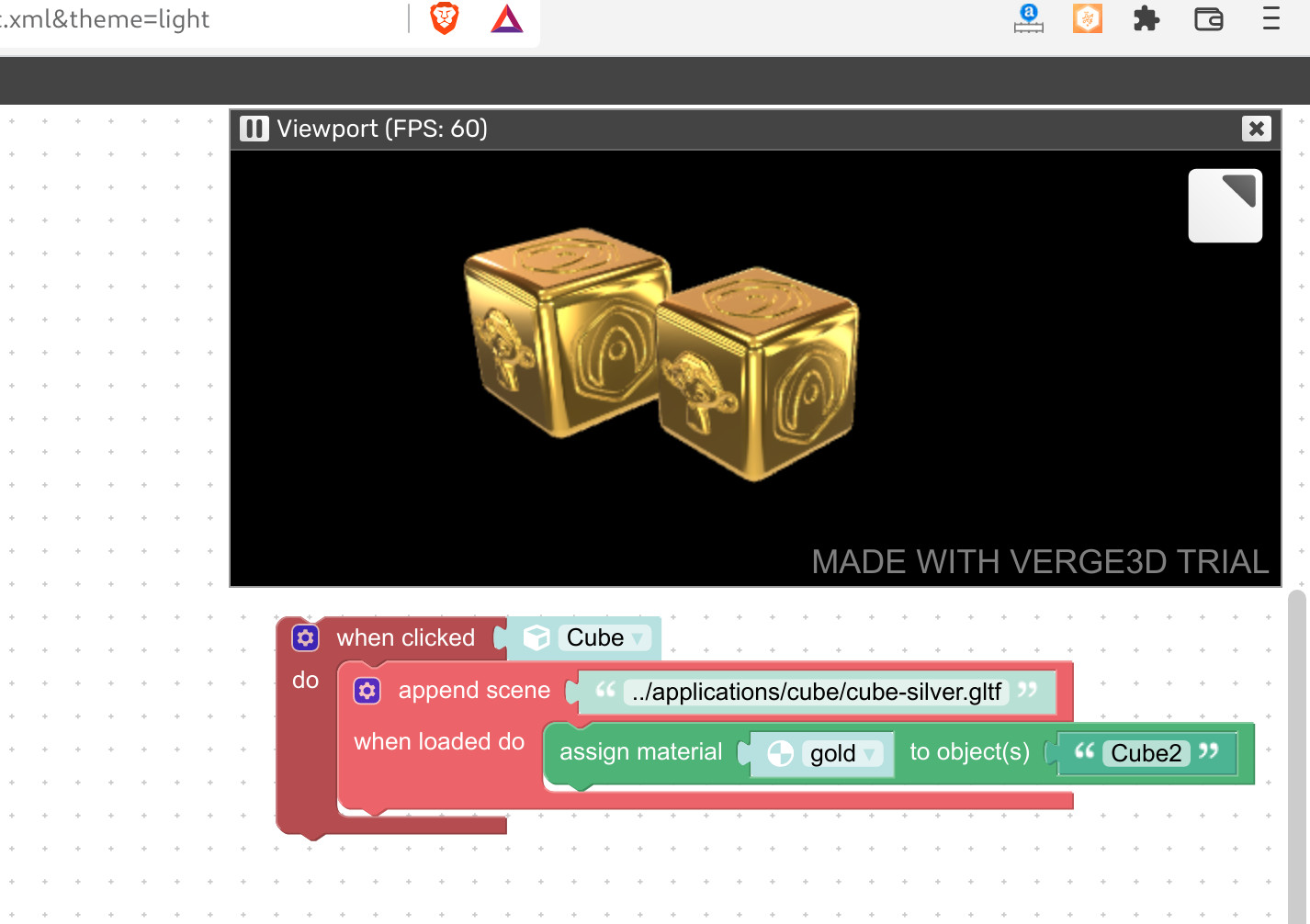

Alexander KovelenovStaffI see.
Regarding the second issue, here is the basic example how this material assignment can be achieved. If done is such a manner, there should not be any additional shader compilation time spent.
