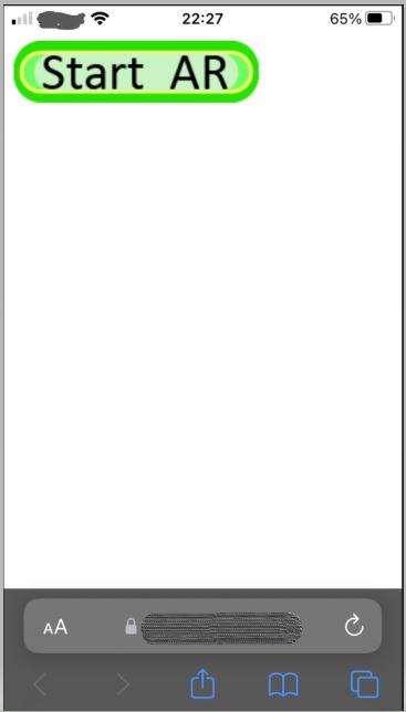

2023-02-09 at 9:33 pm #60266vision
CustomerYes, thats exactly what I mean, it works perfectly in the local browser. But it fails somewhere in the starting of AR-mode/loading usdz.
screenshot of iphone attached
2023-02-09 at 9:55 pm #60268kdv
ParticipantYour app just doesn’t work. No
.css, no.js. That’s why you see only the button in the upper left corner. That is the default position for HTML elements without styles. I suppose you embeded your app via iframe, right? (I wonder why so many people use iframes without actual need???
Who told them to do this way?).Need more information to say more. Give the link to your app.

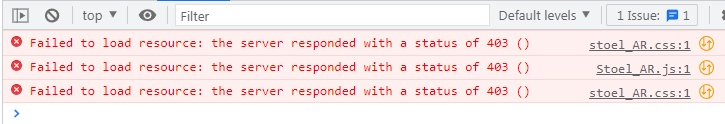

ParticipantAs I said, no
.css, no.js
Serious web-servers based on Linux make difference between small and capital letters ))) It’s important. You have
STOEL_AR.cssandSTOEL_AR.jsin the app’s folder. Why did you type in your .htmlstoel_AR.cssandStoel_AR.js?Puzzles and JS coding. Fast and expensive.
