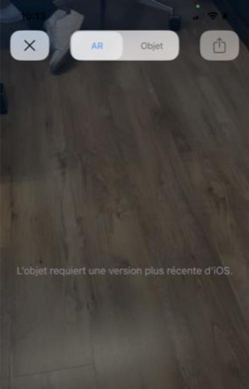

On iOS, it refuses to go inside AR :
I get the darken video, and a message telling that the object need newer version of iOS to be opened.
I’ve uninstalled 4.6.0, back installed 4.5.1, get back old version of my app (i mean 4.5.1 version of it), and iOS is back !"1+1=3... for large values of 1"

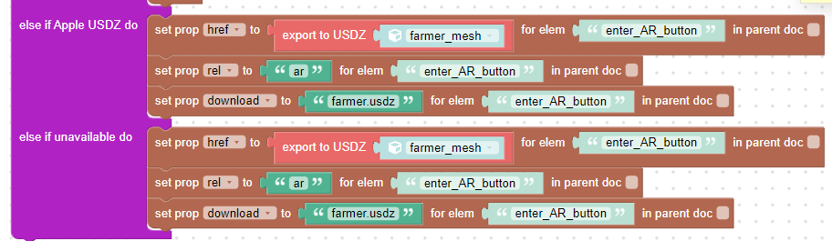

But i do have a serious problem, with another project.I’ve made some 8ball billards table, remember, for my customer “Toulet”,
And the same customer wants now mini soccer tables to be also in Verge3D with AR.So i’ve started from a billard table, removed the objects, put the mini soccer table, and changed the puzzles for configurator choices : i DID NOT changed anything about AR puzzles…
Billards are working (v4.5.1), soccer table are not, only in Android AR (iOS AR is fine).
I don’t even get the “move around” on screen (same puzzle structure than your AR demo from 4.5).
I’ve tried to upgrade into 4.6.0, but here even iOS does not work anymore (same error that swimming pools talked above).If you remind me where to send files, i can provide the full project.

NaxosCGCustomerHere is the error on iOS
It says :
The object need a newer version of iOS.Although my iOS is the very last one.
2024-04-10 at 12:16 pm #72240kdv
ParticipantThe object need a newer version of iOS.
this message is shown when .usdz contains no geometry. some problems with exporting.

Participantbut i export the scene, the whole scene.
So what? You think it’s a garantee of correct exporting?
Duplicate puzzles this way, check the size of exported .usdz on PC (a kind of debugging. don’t forget to make “Enter AR” visible). See the result and console log.
2024-04-10 at 8:32 pm #72252
NaxosCGCustomerThat was not my meaning, just to tell that i don’t export selected with a chace that the selection would be empty.
I’ll test that tomorrow, many thanks !
