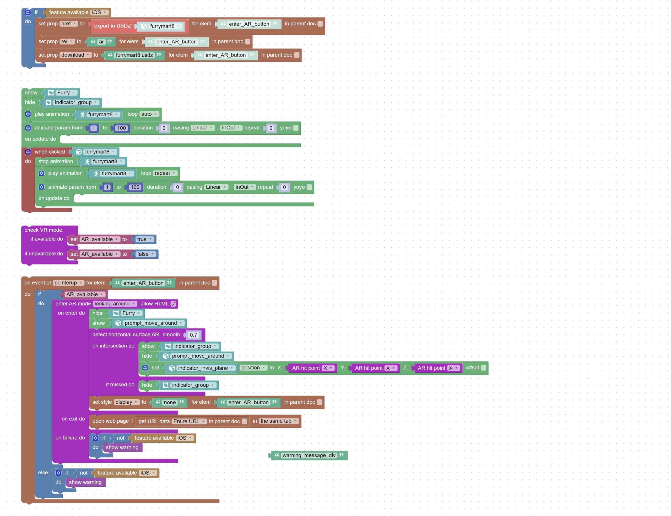

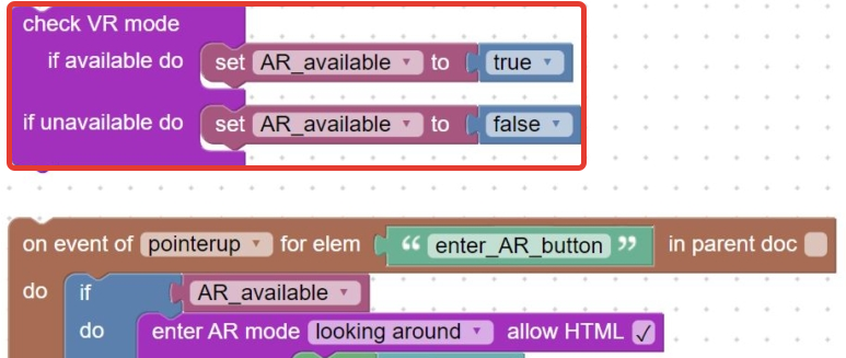

    Why do you check VR mode trying to enter AR mode? VR slightly differs from AR…
    Check out the original demo with more attention and use this puzzle to check AR mode available…

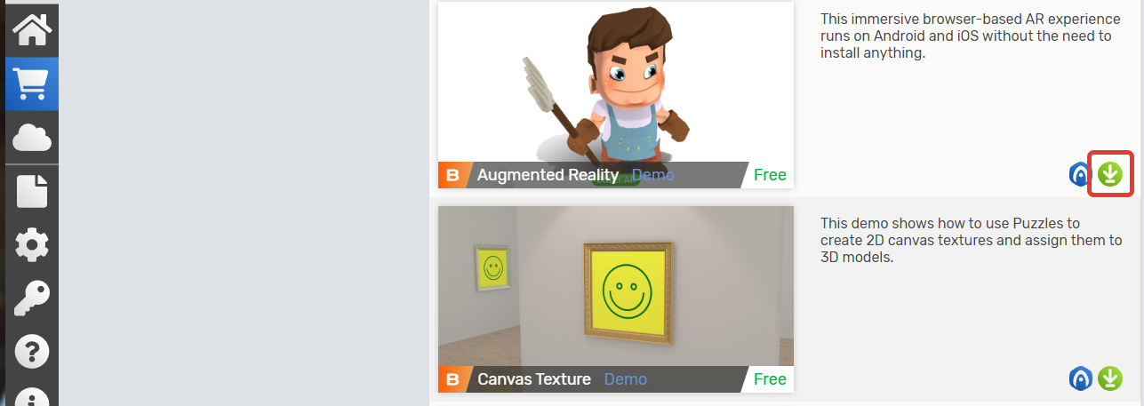

    #63289
    Click the cart button in the App Manager and download the demo

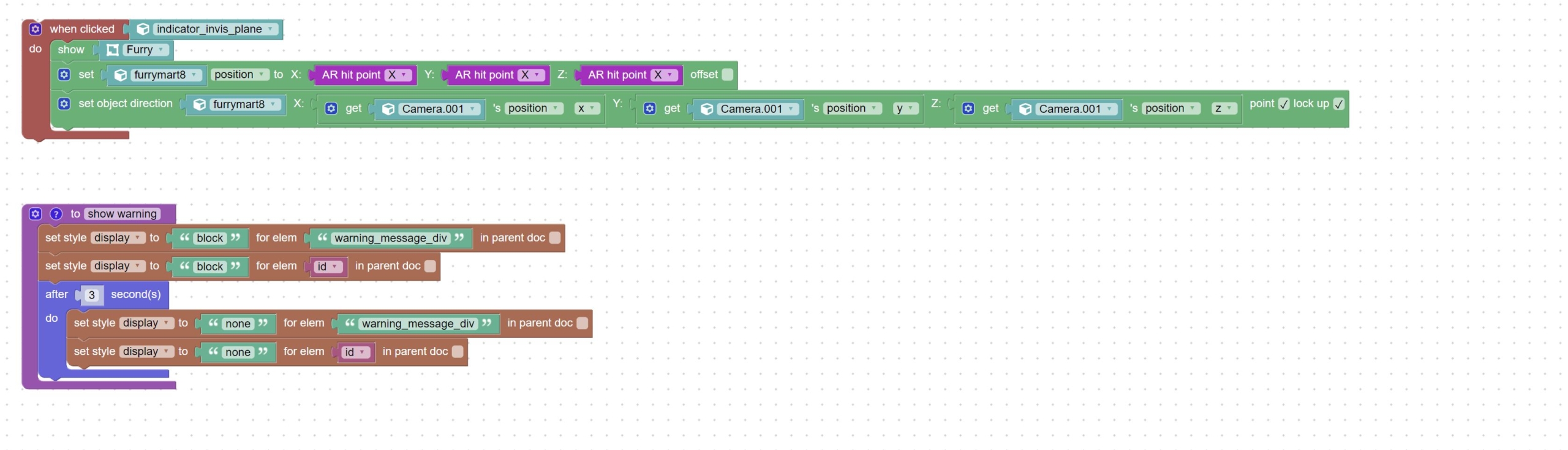

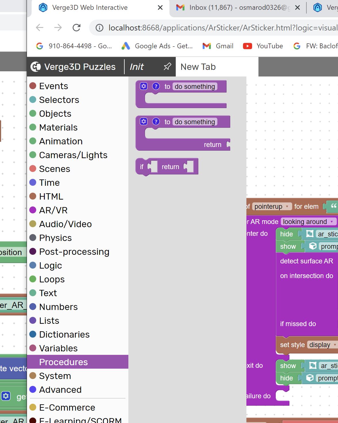

    For some reason i can’t see some of the puzzle? for example: Show warning with id: and a few more?

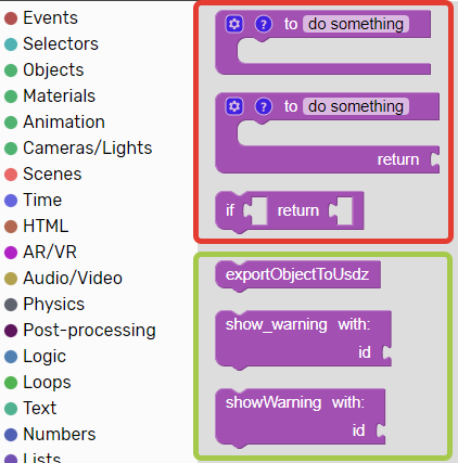

    #63357
    Maybe, because they are user written procedures?
    Red outlined – three default puzzles
    Green outlined – user created

    #63468
    Hi Osmar,
    The missing puzzles apparently come with some Puzzles plugin – we don’t offer these out of the box. You might reinstall the plugin on top of the latest version of Verge3D, which is currently 4.3.1 (there was a problem with plugins and v. 4.3.0).
