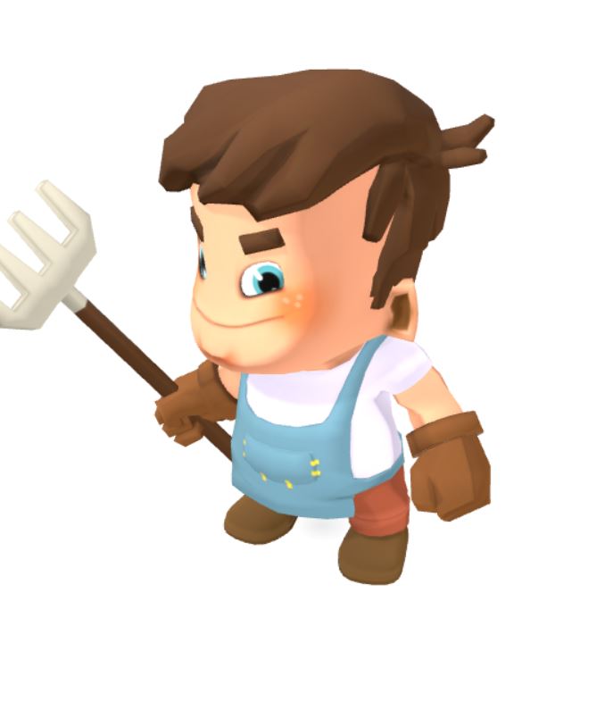

CustomerI have tested the Augmented Reality app before but now the AR-button is missing in the original app. Normally the button ENTER AR is shown below the character.
I have updated the app in the app manager, but still the button is missing. Could you please check this?

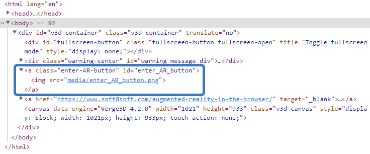

2022-12-31 at 4:30 pm #59298kdv
ParticipantIt’s your browser individual issue. AR buttons are on their places, visible and they don’t depend on the Verge3D version at all. They are just HTML elements on the page.
2023-01-02 at 8:57 pm #59341vision
CustomerI have now tried different browsers, Firefox, Edge, Chrome. No button in any of these browsers.
And as you say, its a simple button and it is present in de code.
Therefore it should be visible in any browser.I want to use the AR, where is the AR “enter” button?
