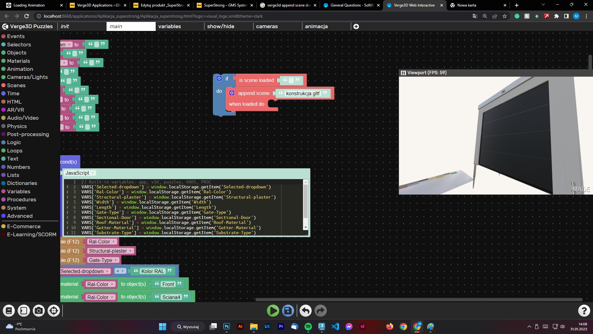

    Hello. I’m trying to make my scene smaller so I have divided it to couple separate files and used append scene puzzles. In verge localserver it works but when uploaded as a WooComerce product it does not. What could cause that ? Should i change paths or something ?

    Do you have the appended scene uploaded on the server. Also verify that the case of the loaded files is correct. See here for more info.

    Hi. I found what the problem was. File was named “Konstrukcja” and i renamed it for “konstrukcja” with lowercase :) gltf was ok but it wasn’t loading .bin :] Thanks
