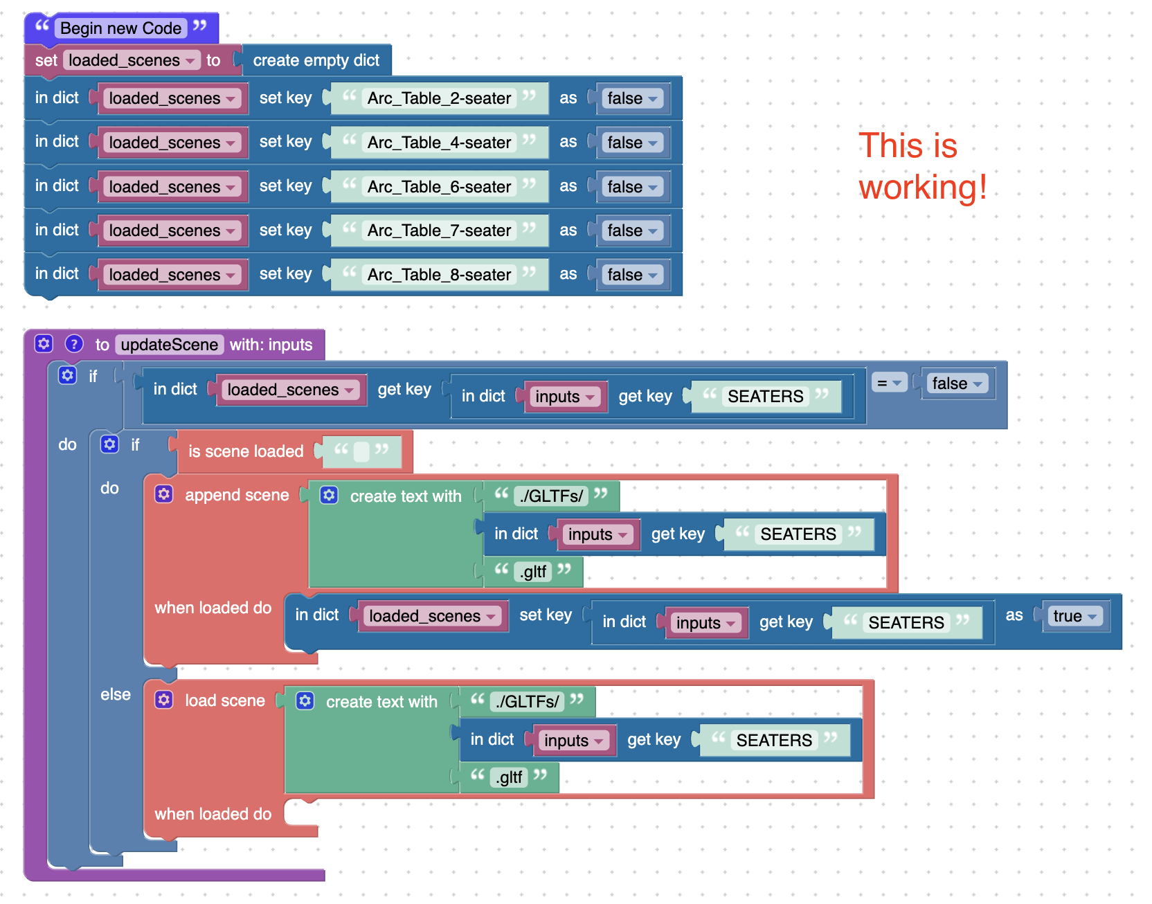

    #65967
    calbrecht
    Thanks for the feedback, but I should probably be a little more clear.
    See the puzzle I have (attached), this works for looping through my pulldown options and appending the gltf. Now, what I don’t know is how to unload the current gltf and append the new one using the very same pulldown.
    As you can see in the screenshot it loops through and checks if the gltf is loaded or not. I have the flag ‘false’ or ‘true’ and it is conditionally set.
    What I’m looking for is to if not in the scene load the gltf, then unload when another one was selected.
    I hope this is a little more comprehensive now!
    Thanks for the help.
    Cris
    #65969
    Absolutely senseless and useless condition.
    With the empty text field it always returns “true” (the main scene app.scene is always loaded). “Else” will never be perfomed.
    Within one condition you are trying either append or load (will never be loaded) the same .gltf file. So it’s really hard to understand what you reaaly want do do. Do you want it to be appended to the current main scene or do you want it to be the main scene? For the first case puzzles are above, in the second case there is no need to unload the current scene (it will be replaced automatically).

    calbrecht
    Thank you Kdv, I got it!
    I want to append GLTFs to main main scene, not to replace everything.
    I will make few adjustments and test, will let you know if I’m good or still need some guidance.
