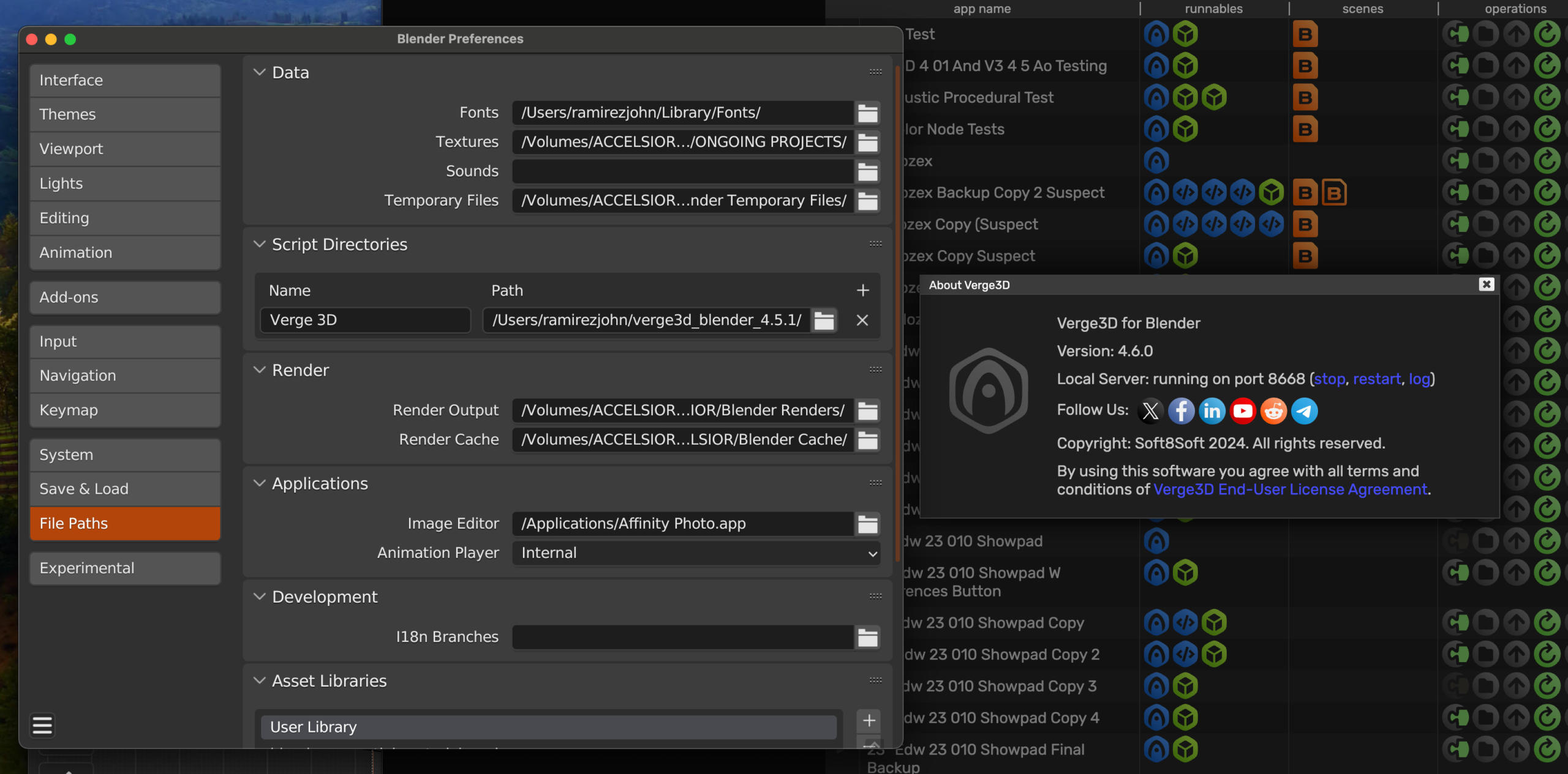

    In Blender the file path points to 4.5.1 and the v3D add on says 4.5.1.
    However when you go to the App Manager it states 4.6.0.
    All the 4.6 changes are visible but the 4.5.1 applications that would normally show they need to be update do not indicate an update is required. The information icon also does not indicate a new version is available as it displays 4.6.0.

    Fantastic….never ran into that before. Problem solved. Thank you.
