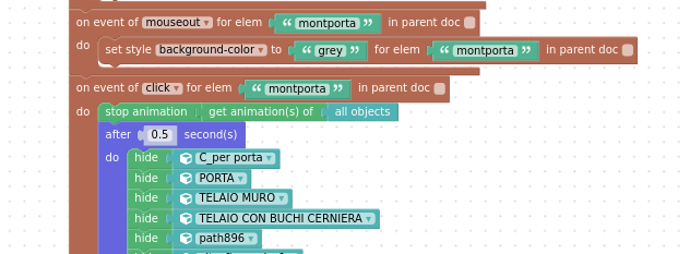

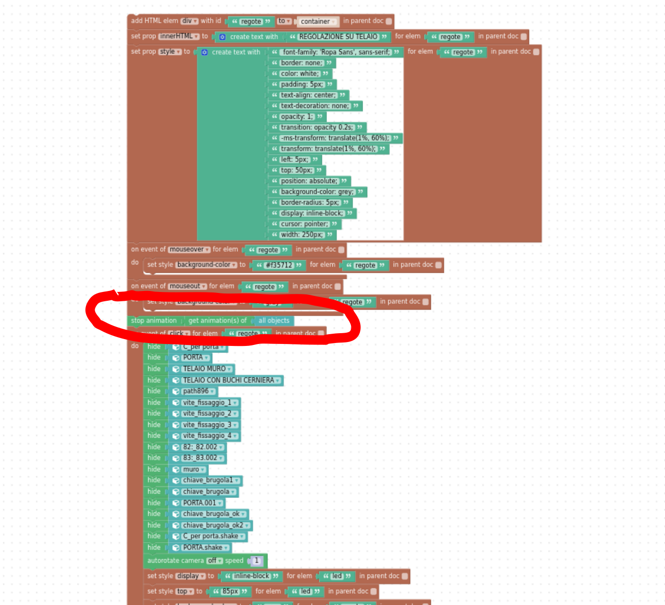

    Have you tried to stop all animation before play another?
    #39272
    Emma
    Hi Mikhail,
    I did this, i hope it is right, but it doesn’t work properly :cry:
    #39274
    Emma
    Sorry error, but it’s same
    here

    A little question. Is there a command that stops the animation exactly where it is at that moment?
    #39379
    Pause Animation puzzle and then you can use Resume animation puzzle to play from last played frame.
