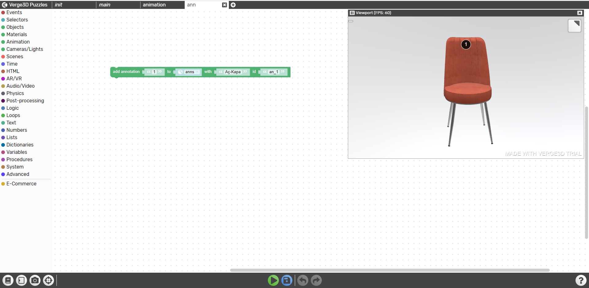

    Hi, i cant be able to link an animation to an annonation. When i use any mesh in the scene for click, the animation run properly but when i pick annotation it becomes red and the animation not working.

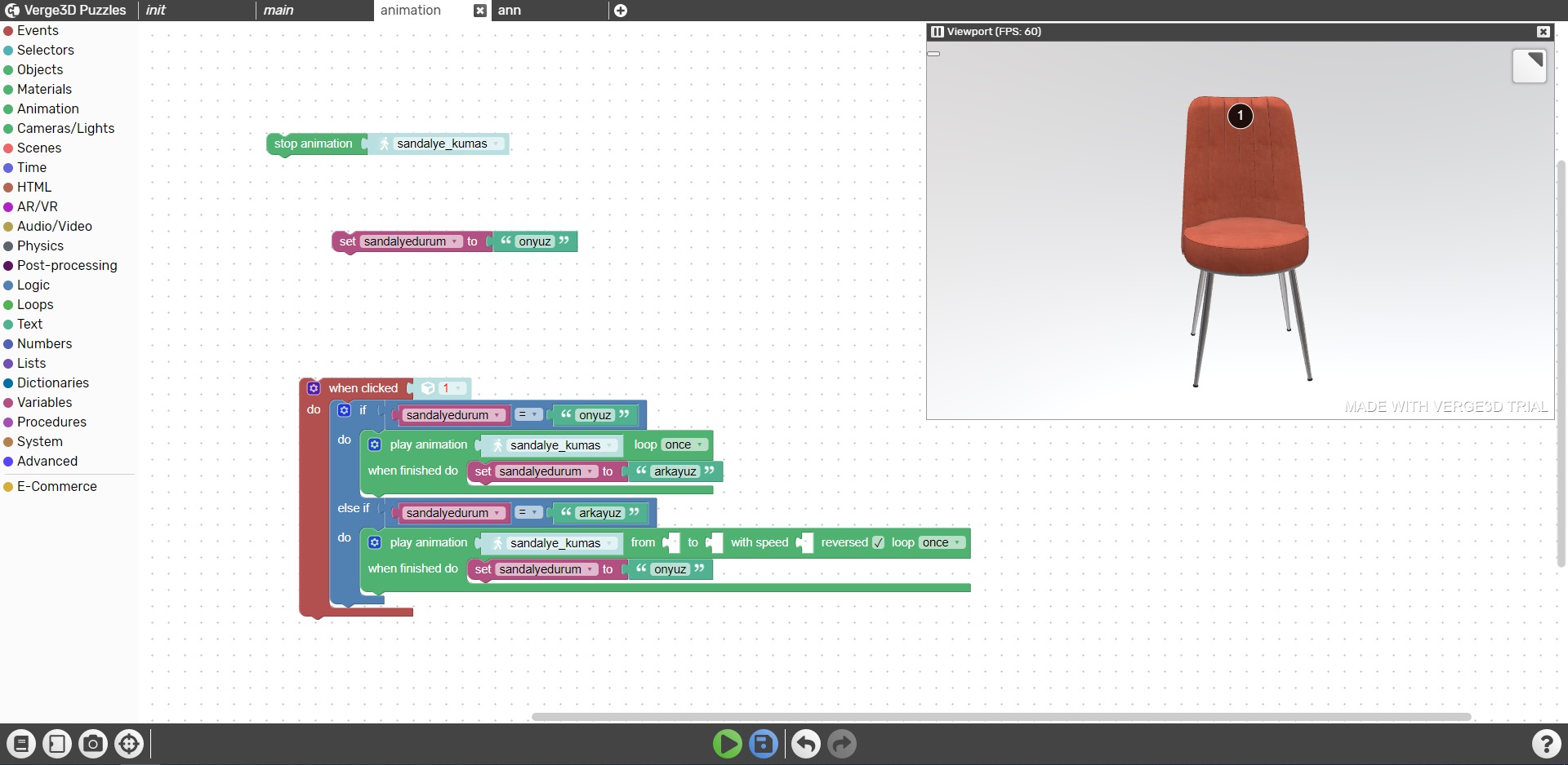

    Your annotation ID is “an_1”
    The onclick Object you are referencing is “1”. Since “1” does not exist it is red.

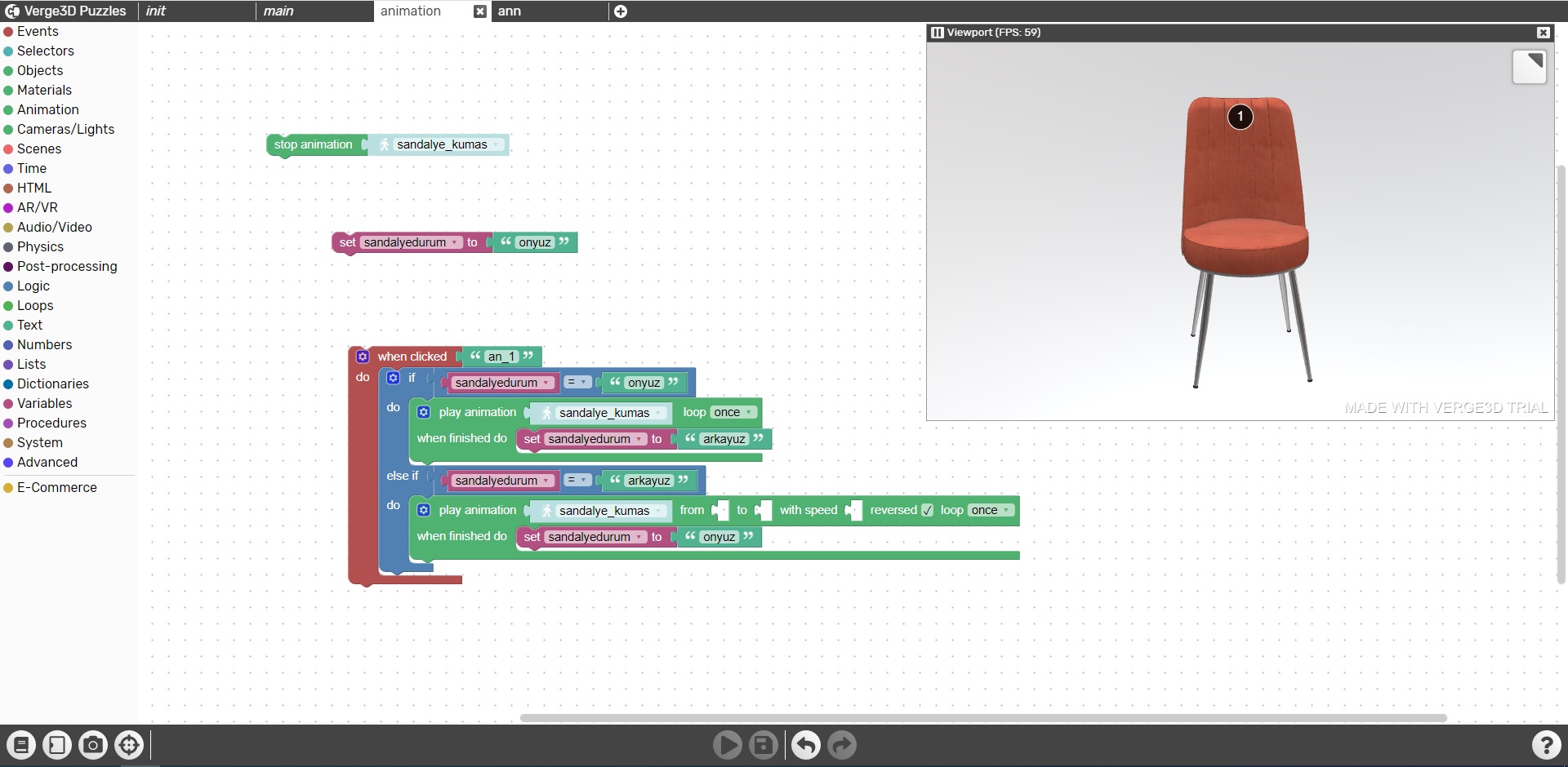

    #44044
    yusuf
    Thank you for your answer xeon. But I already try “an_1” and it still not worked. I do not understand where is the problem.

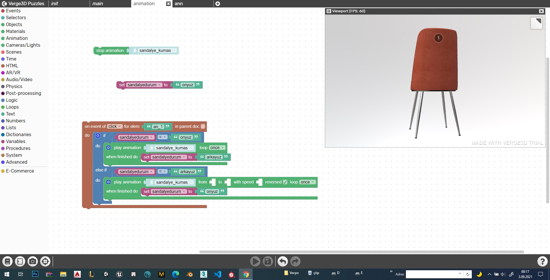

    You need to use event click puzzle instead of When clicked puzzle because annotation is an HTML element.

    Thank you Mikhail, I try it and not worked again :(
    #44260
    Try to put Pring to console out of If operandand see what happened to be shure that exactly On Event Click not working.
