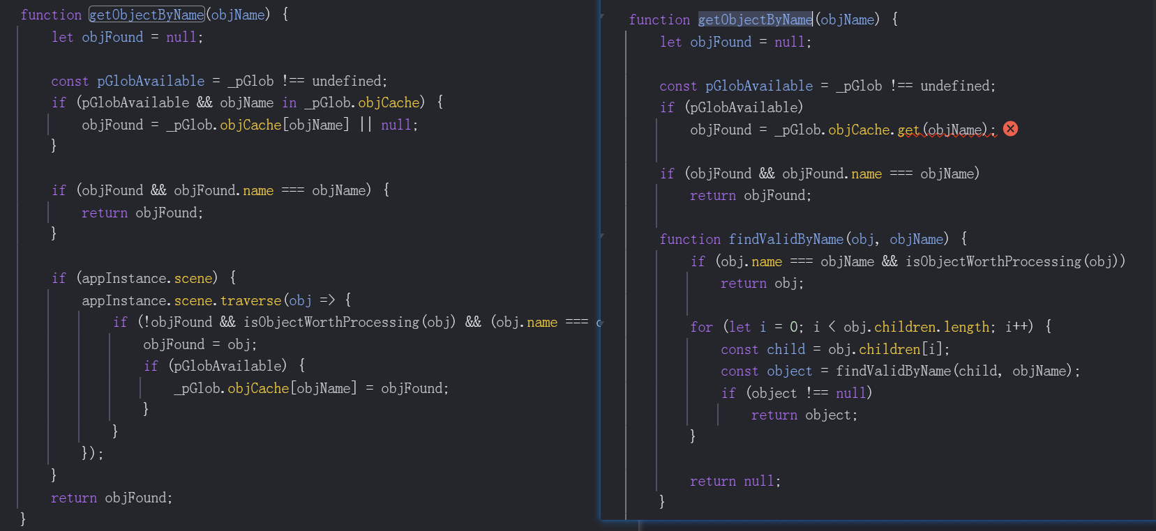

    Hi,I used a 4.8 editor to create a project, but after upgrading to 4.9 and saving the project, I found an error. Comparing the two codes, I found that the commonly used function in pzlib is different. What should I do? Is the upgrade incompatible with the old version

    Uncaught TypeError: _pGlob.objCache.get is not a function
    #80957
    _pGlob.objCache should be present in the beginning of your code and be initialized to an empty Map(). Do you see the following line in your visual_logic.js?
    _pGlob.objCache = new Map();
    If so, perhaps some third-party code or plugin reset this to an empty object ({}), which should not happen normally.

     function destroyOldObject(objSelector) {
                    var objNames = PzLib.retrieveObjectNames(objSelector);
                    for (var i = 0; i < objNames.length; i++) {
                        var objName = objNames;
                        if (!objName) continue;
                        var obj = PzLib.getObjectByName(objName);
                        if (!obj || !obj.parent) continue;
                        obj.parent.remove(obj);
                        // _pGlob.objCache = {};
    :good: Thank you, it has been fixed
