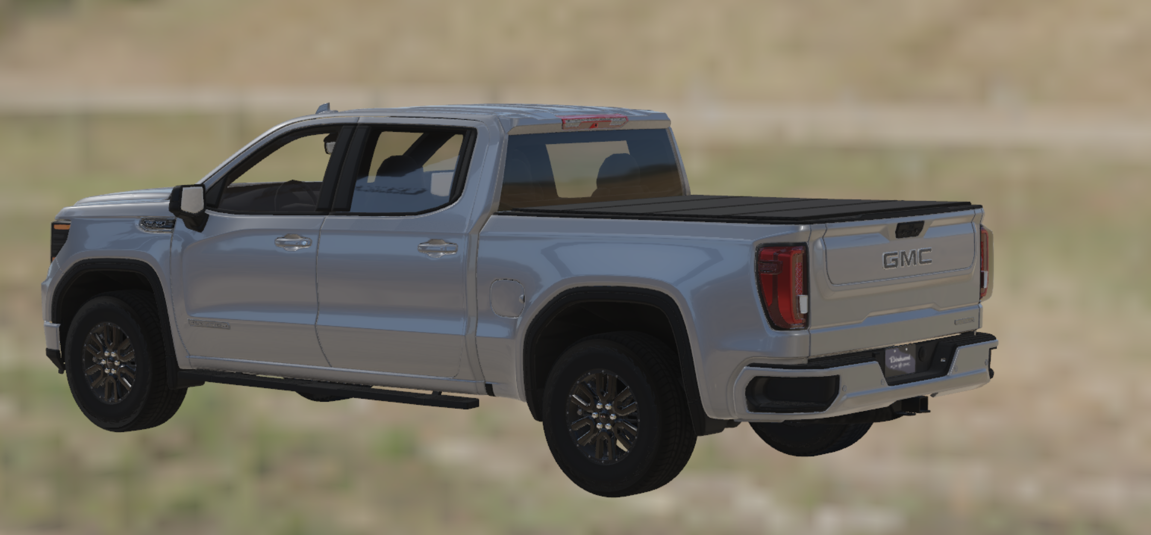

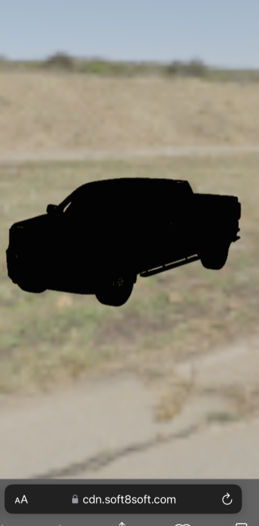

CustomerI am having an issue where on Mobile phones all objects are black, on computers this is not an issue, I have attached some pictures below if anyone has more information please let me know.

CustomerI am testing this on, iPhone 12. I tested chrome and safari

Participant8+ millions of triangles rendered, 3 lights casting shadows (but no shadows are visible without shadow catching surfaces), 4k textures, non-power-of-two textures. Too heavy app for mobile platfoms. why do u use 4k texture for wheels? and it seems to be useless, the wheel protector is not even visible…
2022-12-17 at 7:31 pm #59083tanner
CustomerHow its set yup is things are to be toggled, so only some things are visible, I will optimize the app some more and test it.

Mikhail LuzyaninStaffToo much texture and too much size on them, that’s the reason.

ParticipantHi, I can tray to give you a solution, as I had the same issue.
Did you made your object with Blender?In this case , you need to go to the material shaders in Blender ad see if there is a normal Map attached to your material that in the smartphone shows black.
Delete the normal map and export again your scene.
This method works only if you used Blendner
