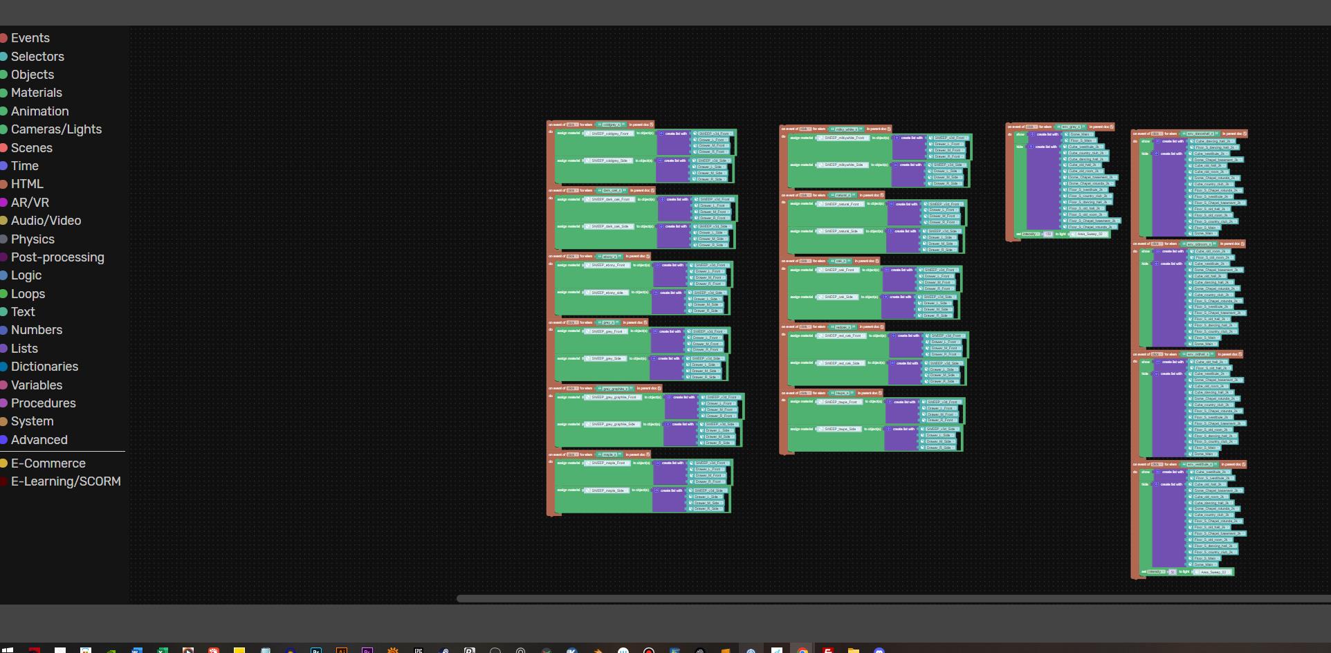

CustomerAnyone know what’s going on here……???
All the menu icons disappear suddenly…there is no change after I update to 4.60…Please help!!
The other apps are all fine……any ways to fix this?……….Please HELP to save my puzzles………….

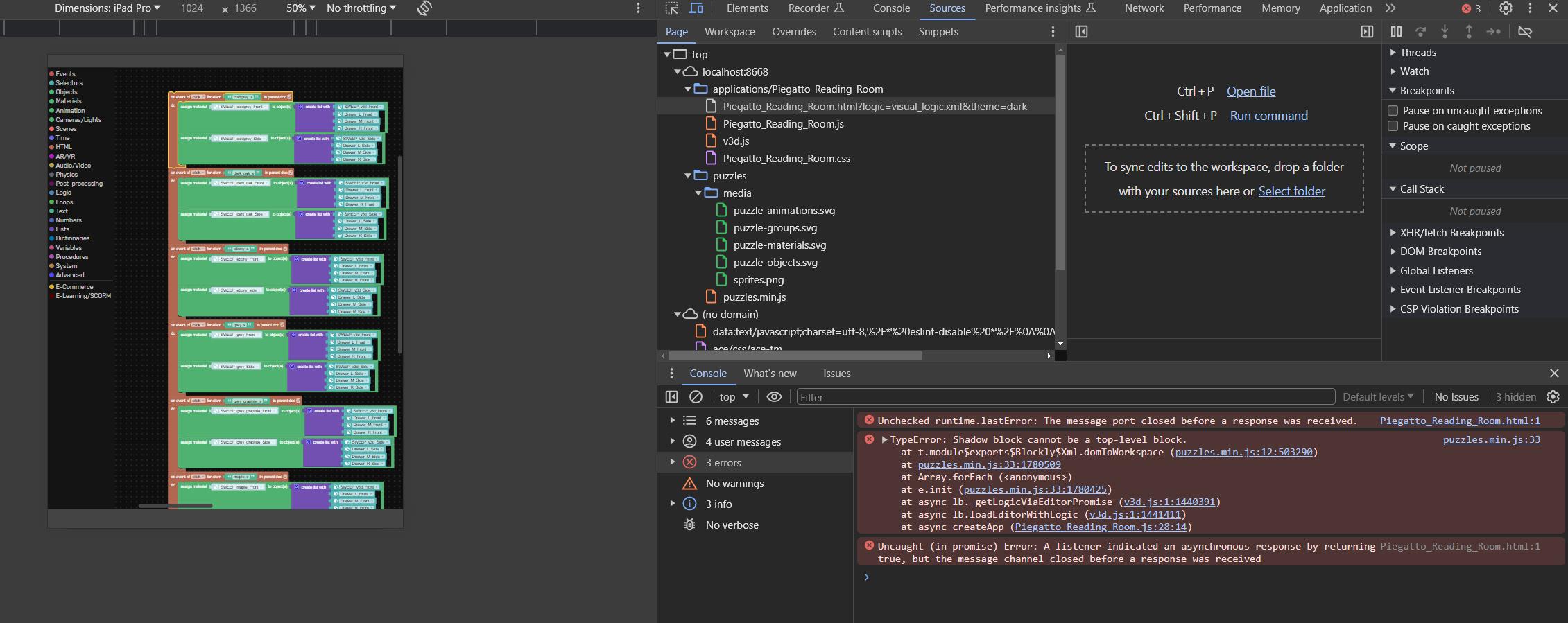

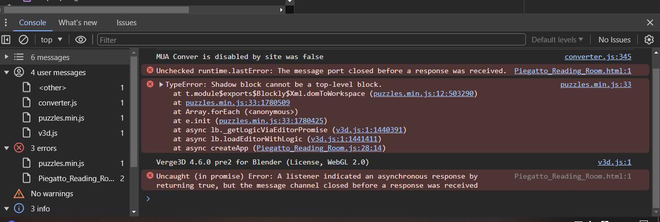

Yuri KovelenovStaff2024-03-21 at 6:09 am #71859gee_lau2000
CustomerHi Yuri,
Yes, there is some error msg but I don’t know how to fix it…….I’m zero knowloage it it……..

ParticipantLooks like they didn’t fix the issue with the top-level shadow blocks
The problem is in line 3088. Replace
shadowwithblockand save.
