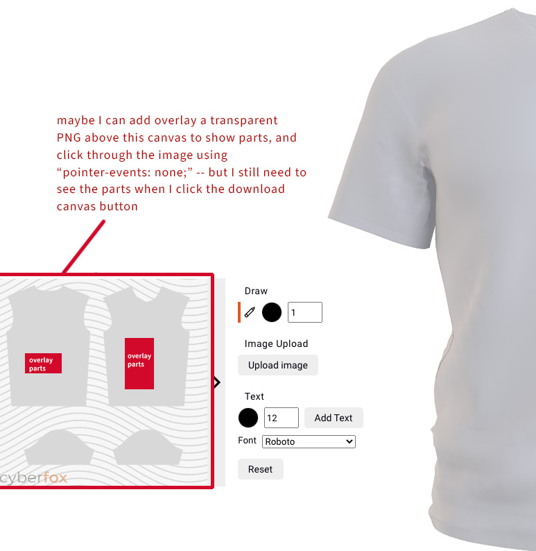

    I am learning how to use the nifty 2D Canvas plugin by CyberFox. I would like to be able to apply a transparent PNG on top of an image that is being downloaded.
    So when the user clicks the download button, I can apply a PNG over the top of the image before it gets saved by a user.
    I was trying to add a PNG using CSS puzzles (z-index and positioning set top:0 left:0) before the “drawer to image” puzzle, but I am not sure what to do to make it work.
    Any hints would be most appreciated, thanks, MJ

    mjdesigner
    Yes! basically that’s the idea – the product has parts that will be in front of the user’s artwork, blocking the view.
    Though, it’s not a straight screenshot as much as it’s the plugin downloading its canvas area.
    So when the user downloads the composited picture they made (they drag in their bits of art on top of the background image) they can see in the download what parts will be covered up by parts.
    Related challenge: I was also trying to figure out how to add an image above the ‘canvas’, but can be clicked though (using “pointer-events: none;” so they can add artwork and still see the parts obscuring the artwork. I am trying to use CSS to add it above the plugin’s canvas. (if you’re familiar with this plugin: https://www.soft8soft.com/wiki/index.php/CyberFox_2D_Canvas_Editor_plugin )

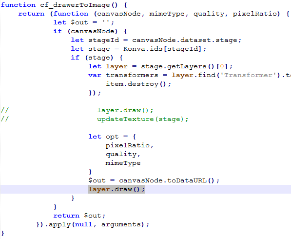

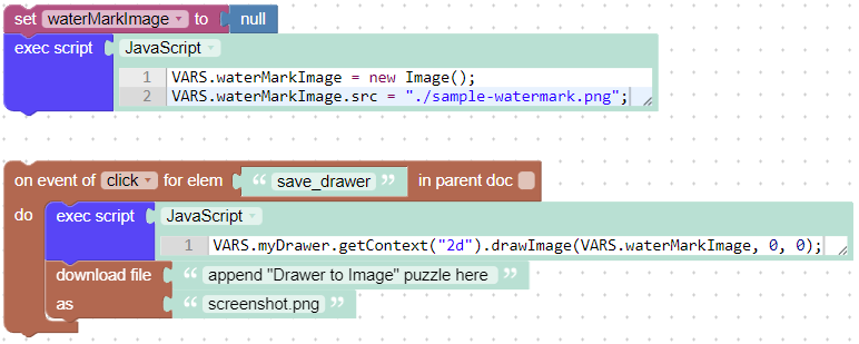

    Well, you need some scripting to do what you want )))
    VARS.waterMarkImage = new Image();
    VARS.waterMarkImage.src = "./sample-watermark.png";
    VARS.myDrawer.getContext("2d").drawImage(VARS.waterMarkImage, 0, 0, 300, 300);
    You also need to change the function cf_drawerToImage().
    Deactivate two green lines and add the line that is selected on the screenshot.
    You can do it in visual_logic.js (but you’ll have to do it every time after saving puzzles) or you can find this function in the plugin files and change it there once.
