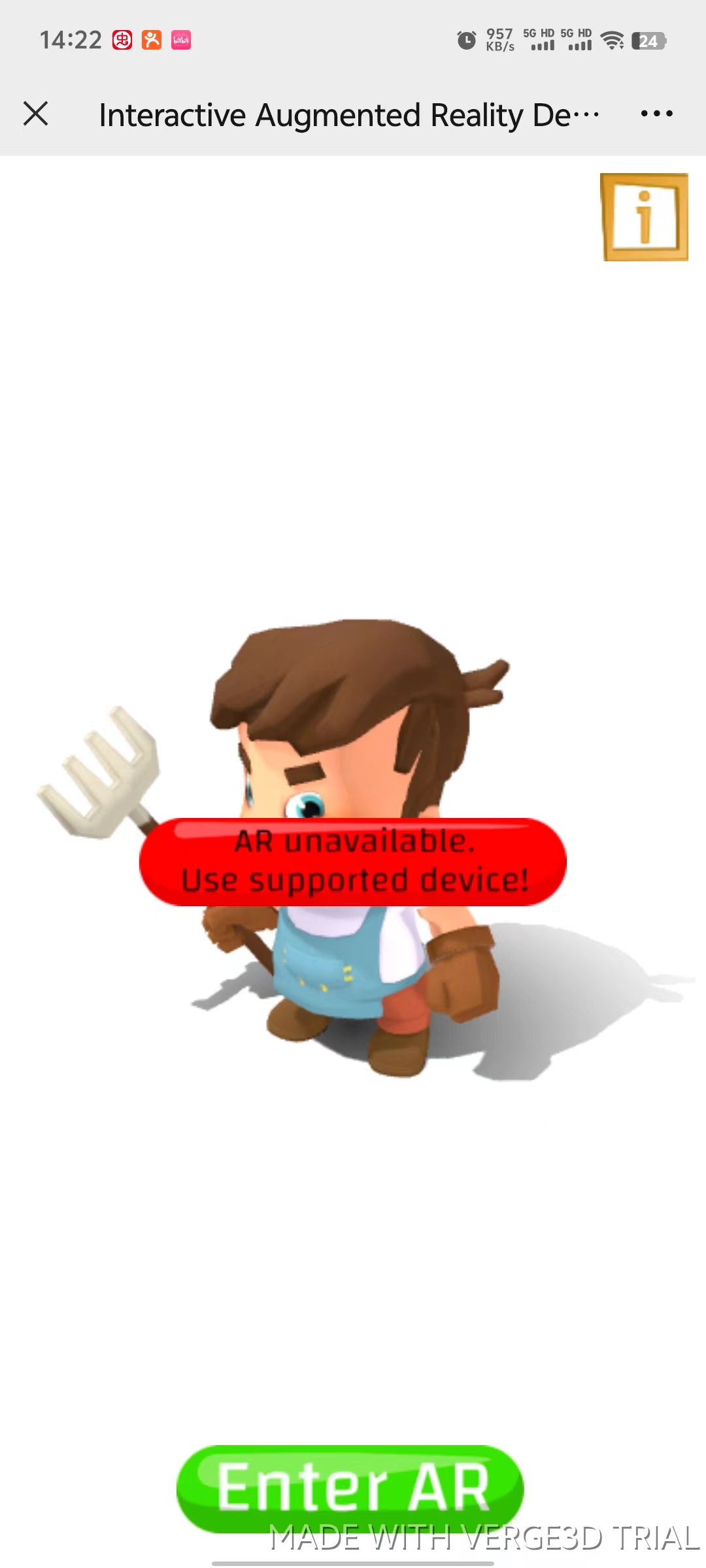

    I have purchased the verge3d license, but when I use VR and XR functions to make projects, I can’t enable VR functions on either Android or Apple phones or tablets, and the message is that this function is not supported. May I ask how this problem comes about? How can I avoid this problem? :yahoo:

    You mean smart phones? I think I use a smartphone, and then my project does not need a Vr headset, I just need to achieve the effect of the official case, I have tested many models of smart phones, can not enable the function, I really do not know what to do! :-( :-(

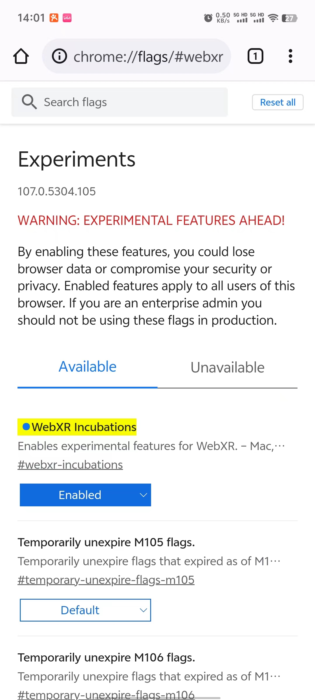

    I followed the document into the “chrome://flags” page to open webXR related options, after searching, the following option appeared, I enabled this option but can not find the options listed in the document, I do not know what the problem is! :cry: :cry:
    #72265
    Did you install AR Core? Is your device supported by AR Core?
    #72266
    this is not applicable for long time already. What documentation are you using?
    No need to enable any WebXR features in the browser. It will ask you to install AR Core for the first time.

    Unfortunately, the AR features of Verge3D cannot be directly used on most of the Chinese brands’ Android devices. To use this, at least the following steps are required:
    1. Install the Google Services Framework.
    2. Install Google Play Services for AR.
    3. ​Install the Chrome browser, as the default browsers provided by these brands generally restrict WebXR api.
    We have previously recorded a video about how to set this up:
    https://www.bilibili.com/video/BV1cw411d79g
    Additionally, here is the complete documentation on the process:
    – Enable AR feature https://www.yuque.com/verge3d.cn/faq/wo2k2h
    – Use Verge3D AR template https://www.yuque.com/verge3d.cn/faq/ar_template
    However, almost every Chinese brand has its own customization on Android, this method may not be applicable to all smartphones.
