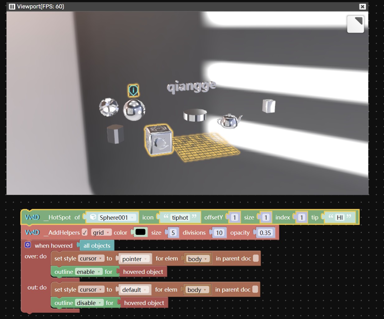

    “Script-created sprite objects and grid helper objects in the scene are automatically given borders when there is no mouse hover. Does anyone know why?”

    HI Yuri
    I made a test sample, please take a look
    demo
    #71238
    That’s an old bug. I mentioned it a long time ago here
    https://www.soft8soft.com/topic/verge3d-4-3-for-blender-is-out/#post-61636
    #71239
    QiangGe
    Yes, kdv, there should be an error in the routing calculation logic
    This bug is quite serious. As long as using outlining, all added Helpers objects will be automatically outlined, including object camera lights and other Helpers
    #71240
    Use OtlinePass.js from three.js bundle. It doesn’t have this bug.
