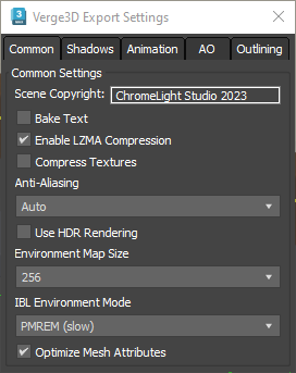

NaxosCGCustomermmm, it seams that i don’t use compressed textures…
The long wait occurs after the export is done (and fully done as i can use it in verge3d app manager as soon as the progress bar is off.Attachments:
