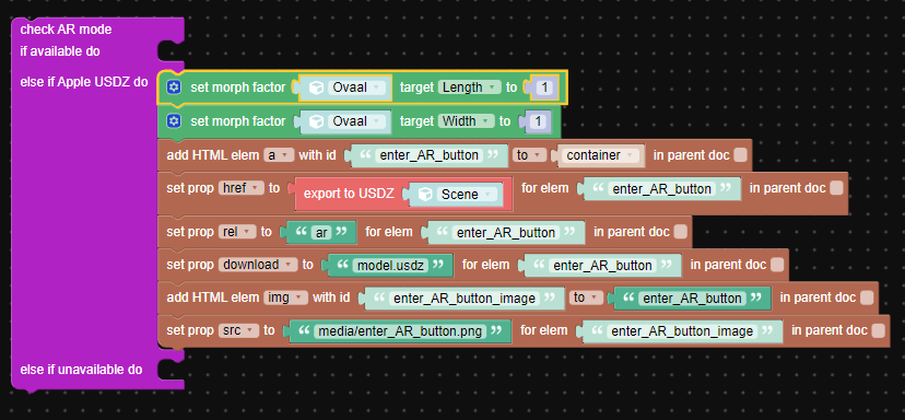

    I’m trying to scale my model through shape keys as you can see in the attached image. That works great when looking at it in 3d. But when I open it in AR, the model is back to it’s original size.
    How do I keep my morph factor when exporting to USDZ?
    Thanks!

    vern
    So is ‘1’ the scale you want when going into USDZ or are you changing that number again somewhere else?
    #53257
    pimmartens
    The ‘1’ is just to see if I was able to get the scaled model in AR. Later I want to have more morph shapes.

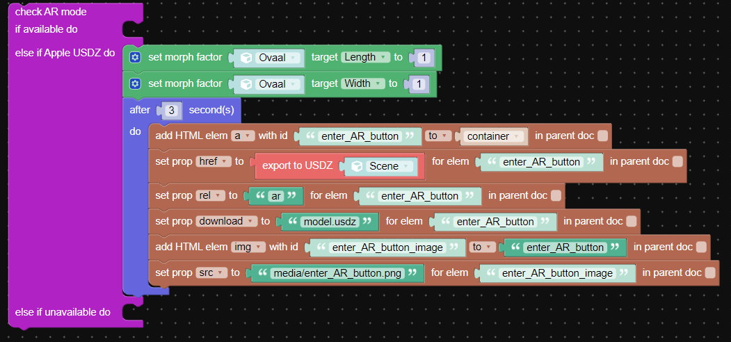

    Try putting all of the puzzles below the 2 morph puzzles in a ‘after seconds’ puzzle from the Time tab. I’d say try 2 or 3 seconds just to test and make sure it doesn’t have to do with the morph targets not being finished when the USDZ is exported. Let me know if it’s still the same issue.
    #53414
    pimmartens
    Hi Vern, it still opens in the same size. I’ve added a screenshot of the puzzle in case I’ve misunderstood your explanation.
