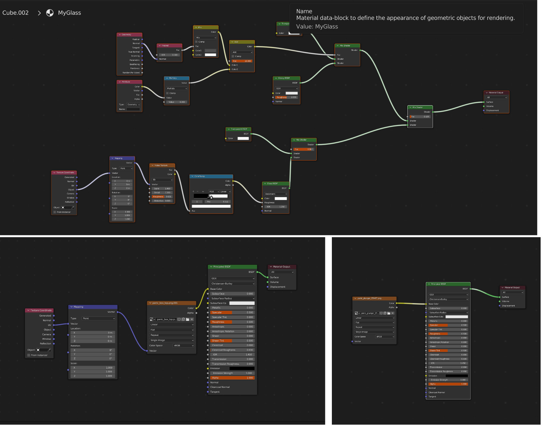

    If you are using a texture that you received or created outside of Blender then that program will assign a color space to the texture. You will want to be sure the color space is sRGB. Not Adobe, or some other color space. If you are not sure what colors space was used go back and open the file in Photoshop or Affinity Photo, whatever you use and
    Your node trees do not affect the color space so as long as you are using supported nodes. Once you have all your applications, textures, and their corresponding color spaces in sRGB your output will be in the best spot to support the most comprehensive number of devices.
    Here is a link to some good info on this subject:
    https://www.eizo.com/library/management/web-color-management/
    Here is a link to a demo: https://webgl.r66dapps.com/escapev1/
    That uses lots of different textures three sample node trees shown below. Just keep in mind the node tree has nothing to do with color space as long as they are compatible nodes.
