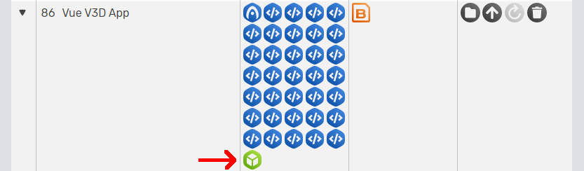

If you still want to use puzzles with a vue.js application, then you can try the following approach:
1) if you created a vue.js application by following this tutorial and placed it in the “applications/” directory inside the verge3d SDK, then you can see it on the app manager page:
If you click the green button you load the scene’s gltf file within the standard verge3d player. Its URL should look something like this http://localhost:8668/player/player.html?load=../applications/vue_v3d_app/public/v3dApp/app.gltf
2) After you opened that gltf file you can append “&logic=../applications/vue_v3d_app/public/v3dApp/visual_logic.xml” to the URL in order to load the gltf file within the Puzzles Editor (you only need to rename “../applications/vue_v3d_app/…” to “../applications/MY_PROJECT_NAME/…” depending on how you named you project).
If you open that new URL http://localhost:8668/player/player.html?load=../applications/vue_v3d_app/public/v3dApp/app.gltf&logic=../applications/vue_v3d_app/public/v3dApp/visual_logic.xml you will open the gltf file inside the Puzzles Editor and you’ll be able to add and save some puzzles.
