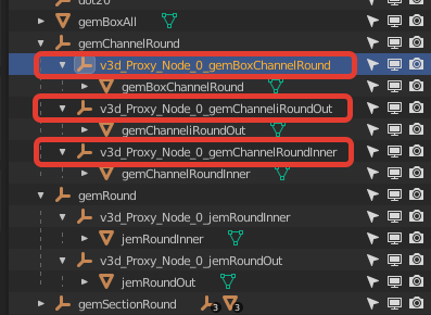

ParticipantThat’s a really old app (2.13.0) and even if you re-export the model now most likely it won’t work with the old scripts. Or you should install Verge3D 2.13.0 to work with this app. And first of all you need to get rid of all
v3d_Proxy_Node_objects before re-exporting. Those intermediate objects were automatically created for every parented object at the previous exporting.

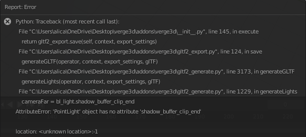

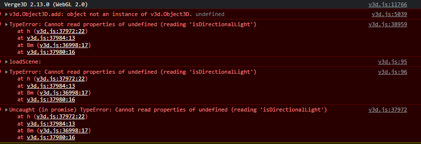

ParticipantI tried but i didn’t make :( I removed v3d_Proxy_Node… then i tried export but returned error. Error is PointLight object has no attribute ‘shadow_buffer_clip_end’. After that i tried change with javascript in code but this returns error cannot find material. Again i removed v3d_Proxy_Node manually then it returns error Cannot read properties of undefined (reading ‘isDirectionalLight’). Can you help me?

2023-05-03 at 4:50 am #63437cangunes

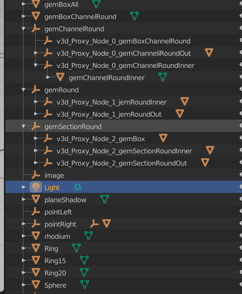

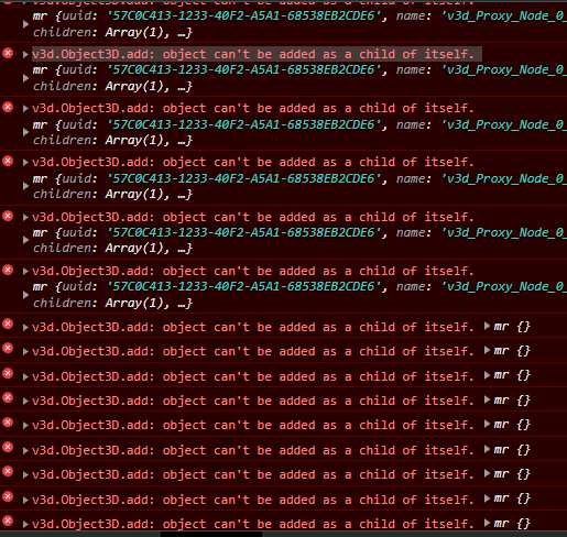

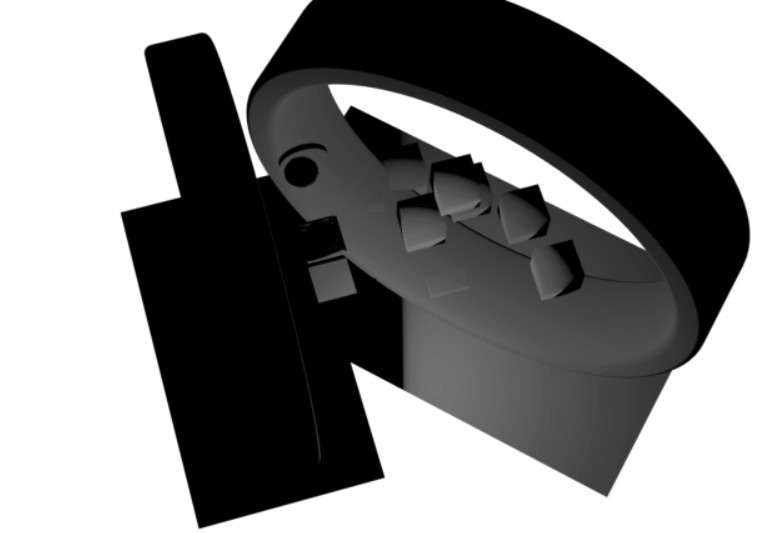

ParticipantHi kdv, I got a error about light. ‘PointLight’ object has no attribute ‘enable’. I fixed it, closed light’s shadow property then i can get exporting glTF file. After that i tried to remove v3d_Proxy_Node elements it works but model is showing differently. Not changing color etc. I put images about it. So, i don’t remove anything, just get exporting glTF file then imported project, i am getting new error. Error is v3d.Object3D.add: object can’t be added as a child of itself. I don’t know, how can I fix that? When I delete v3d_Proxy_Node, the model is exported, but the model does not change color etc. It gives an error when I do not delete it, export it directly and use it.
2023-05-03 at 10:08 am #63447kdv
Participantv3d.Object3D.add: object can’t be added as a child of itself
That’s because you didn’t delete
v3d_Proxy_Node_. Objects with such names are created automaticaly by Verge3D exporter for every parented object. And they do not exist initially in .blend file. But if they exist in .blend (after importing from .gltf) then there will be a conflict when re-exported.the model is exported, but the model does not change color etc
What version of Verge3D is used? Did you try 2.13.0?
