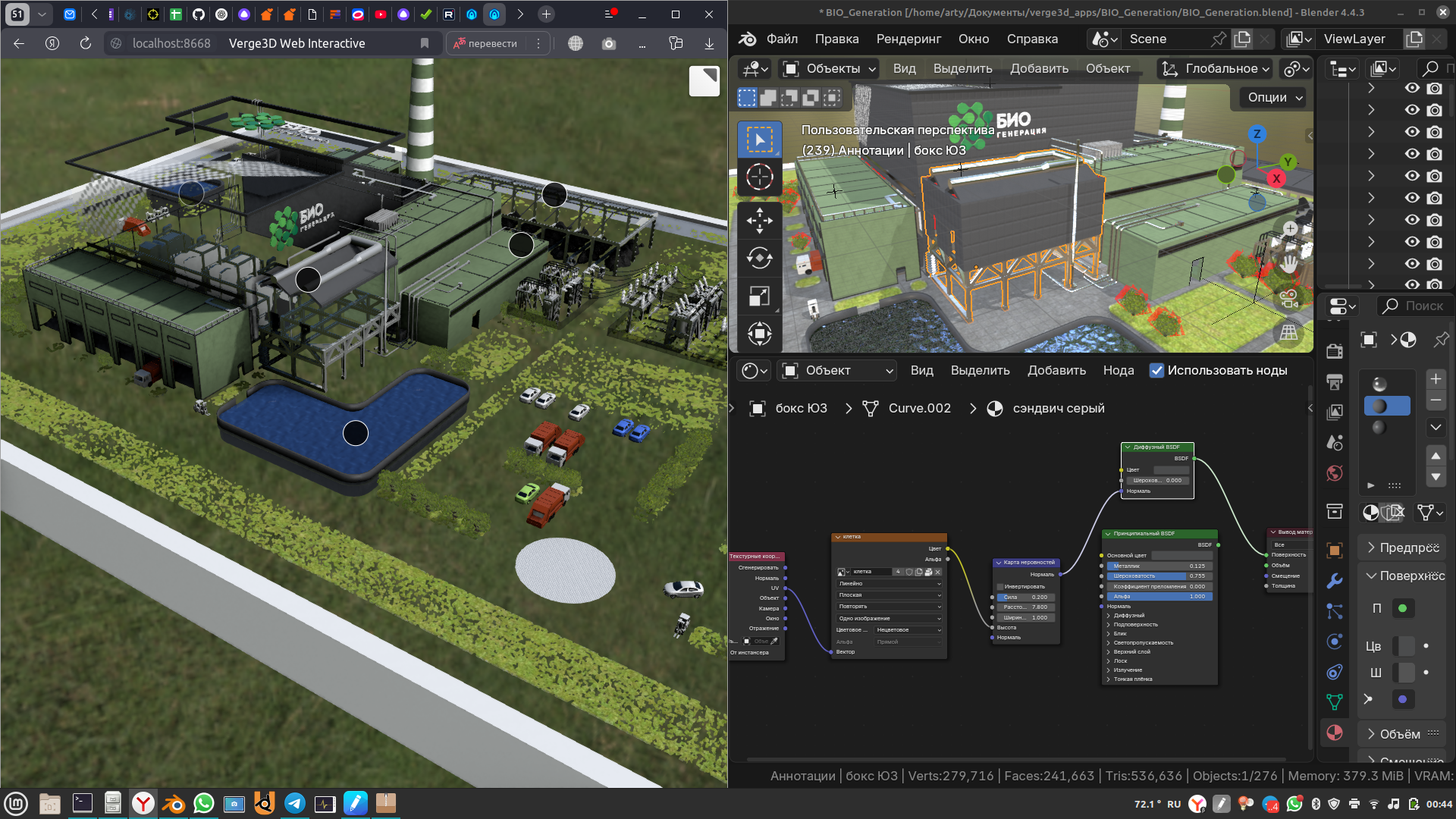

    Hello, dear developers, thank you very much for your work and new releases. Found a small bug.
    During the pipeline, my colleague and I worked on different versions of blender, he on 4.3, I on 4.4. We encountered a bug: if the material contains materials connected via the Bump node, then when exporting to GLTF from blender 4.4.3, the material begins to display transparent (only shadows are processed). (A similar procedure on 4.3, 4.2 and earlier gives a normal result). I tried to do it via Displacement, it is displayed in blender, the color of the material is displayed in the browser, but the displacement effect is not.
    Tried the same on Diffuse BSDF. Same crap
    UPD Partially solved by replacing the Bump node with a Normal map node

    #82510
    It appears to be the same issue described here (bump node crashing when exported from Blender 4.4). The issue has been resolved in 4.10 pre2, so you might need to update. If updating to the preview version is not an option, you’ll need to wait a couple of weeks till stable 4.10 is out.
    #82512
    Артём
    Thanks a lot! :mail: :good:
