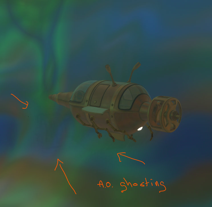

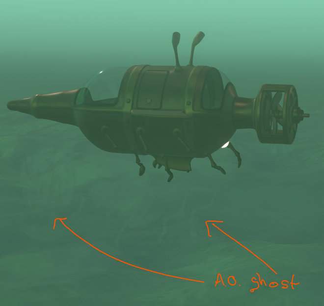

    While testing the new (Eevee) AO for my Vehicle Fantasy, I found a problem with “ghosting” after changing scenes. An AO ghost of the latest view of the first scene seems to stay present in any new scene.
    I have included some screenshots where this “ghosting” can be seen.

    Anyway, I hope the AO “ghosting” problem (when switching scenes) can be fixed.

    Hi Simone,
    Thank you for the feedback! There will be improvements in the AO implementation before the final release. Hopefully those artifacts will disappear.
