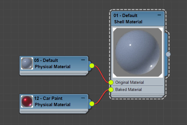

CustomerMaterial shell support for 3dsMax

Yuri KovelenovStaff2020-03-31 at 3:56 pm #25175web
CustomerWorking with the 3.1 pre1 release now for about a week and didnt got any issues so far
I just found one bug related to the new shell material support. Verge is exporting the baked material without any problems and as expected. But also exports the maps for the original material, even though the materials isnt used. Maybe you can have a look at it.
2020-04-07 at 9:45 am #25397
Ivan LyubovnikovStaffBut also exports the maps for the original material, even though the materials isnt used.
Fixed! This should work in the next verge3d update. Thanks for the report
