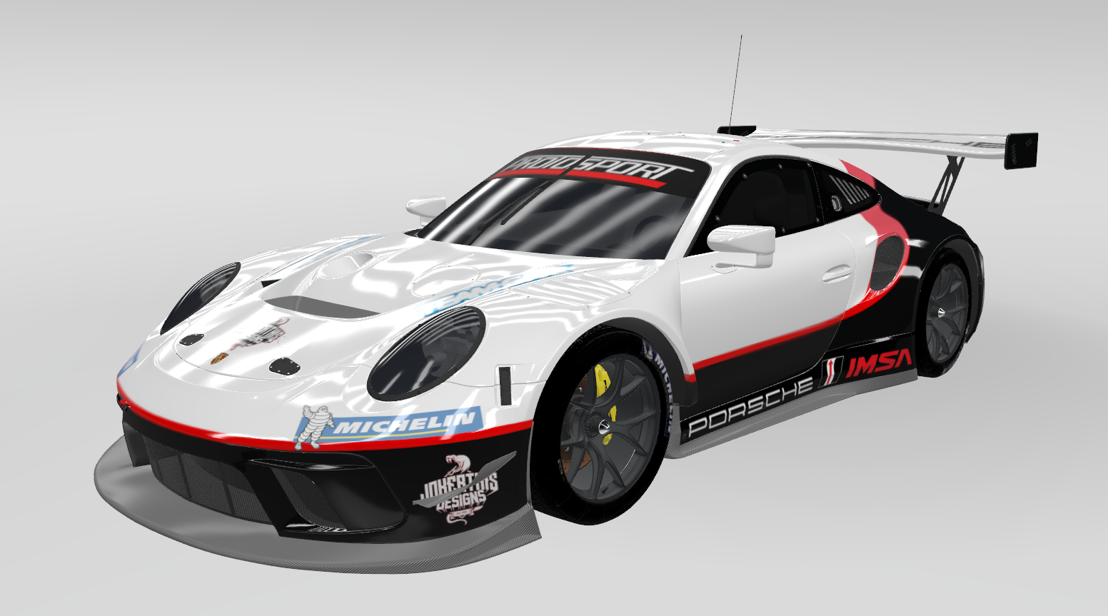

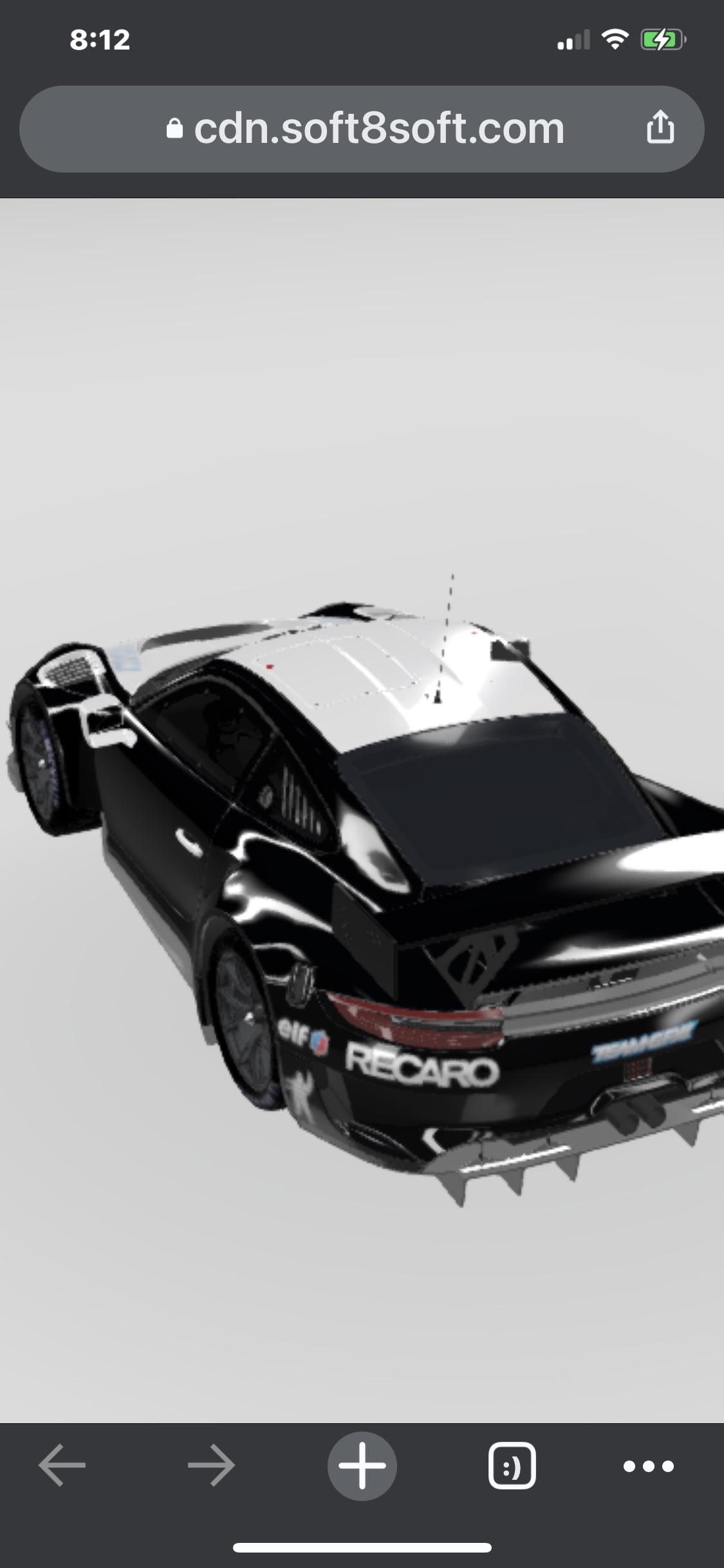

    So here we are, troubleshooting Verge3D.
    again.
    – looks like this on a PC, (first image).
    Then second image is what it looks like on a phone (black body where mapping is missing).

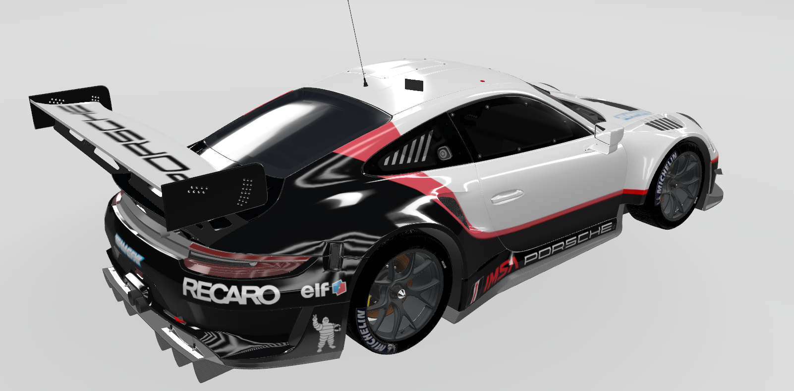

    #35390
    Avatarlbpa
    also notice the mirror (reflective) in this PC image

    on a phone
    what phone model? could you share the link to your app? thanks.

    Both Android and iPhone yield the same results.

    #35510
    I see you’re running Verge3D 3.4.0 pre1. Can you update for the stable 3.4 version and see if it helps?

    #35516
    Although I don’t think it will help. Your app keeps crashing browser tab for me, indicating memory issues. May be you have too big textures?

    #35552
    What is a reasonable total amount for textures?
    you might prefer 1k resolution and lower (power of two: 1024, 512 etc)
    Should I recompile the project under 3.4?
    after updating your Verge3D installation, you should also update your app via the update button in the App Manager. Also reexport the scene and re-save the Puzzles.
