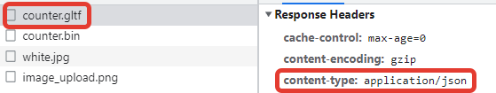

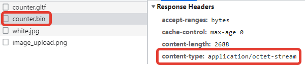

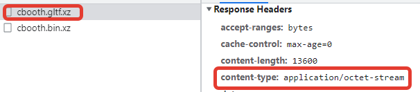

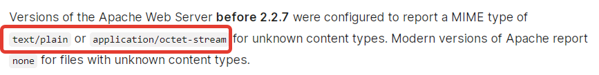

You can find all supported mime types in this file
Or you can use the universal type
application/octet-stream

For those keeping score: So far, the answer appears to be: Adding this to my web.config stopped the gltf.xz error I received and in addition to fixing new errors that cropped up as a result, since :
<mimeMap fileExtension=".gltf.xz" mimeType="application/zip" /> <mimeMap fileExtension=".bin.xz" mimeType="application/zip" /> <mimeMap fileExtension=".hdr.xz" mimeType="application/zip" />..resulting of course, in an entirely new error I am now coping with, for the teapot demo:
v3d.GLTFLoader: Couldn't load texture teapot_heater_OcclusionRoughnessMetallic.ktx2All I could find on that format is summed up in this addition to my config file, that solves nothing:
<mimeMap fileExtension=".ktx2" mimeType="image/ktx2" />= I still get that error.Never a dull moment, is there? Which again brings me to the same question: Why is the Verge3D network able to serve that format? What configuration are they using that allows it? If I knew I could configure my server to do what theirs is doing.

Participantuse the universal type
