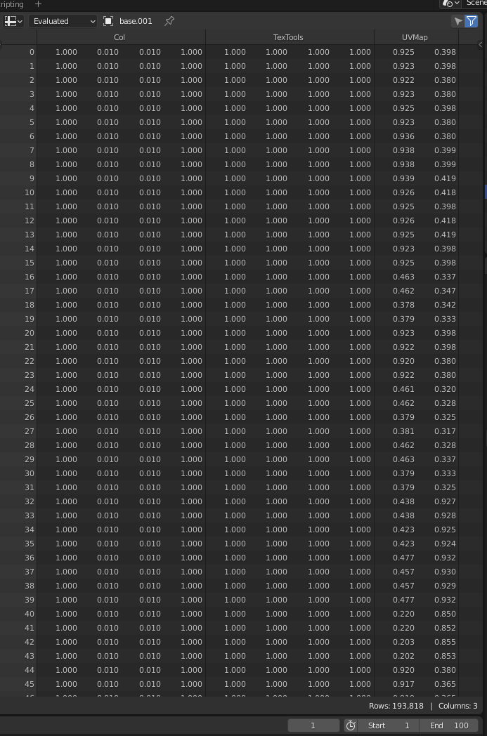

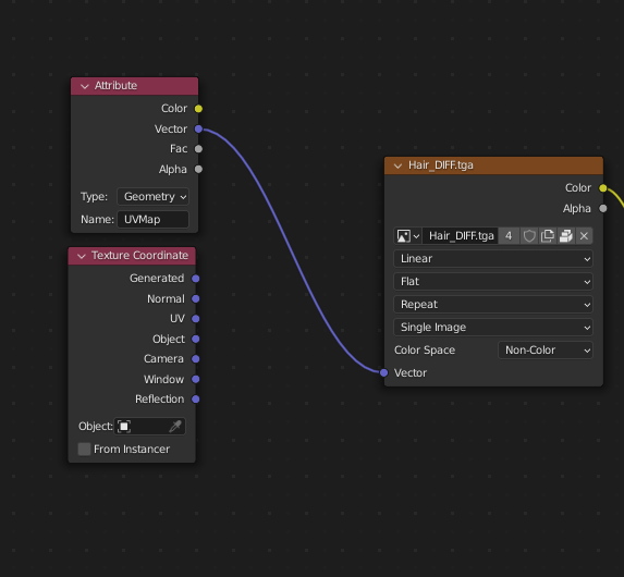

    Hello, is there a way or will devs implement this option in future? I need this UV setup to work my mapping. See my attachment

    what effect would you like to achieve? may be there is another way.
    #48341
    Why you just not used a simple UVMAP node?

    Because I am using UVMap generated by Geometry nodes. See the attachments spreadsheet. And because I just instanced an object around my main model and need to have same UVs on instanced as a source object from I instanced. Hope it is clear now. PS. I lose instanced object UVs if I apply the geometry nodes. If the Verge3D supports the UVs generated by geometry nodes, it will fix my problem.

    I build it in Geometry nodes and after join geometry node, the UVmap is converted to attribute. Here is a link 80MB. https://we.tl/t-BeyTzhVLFB
