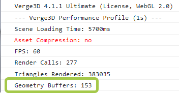

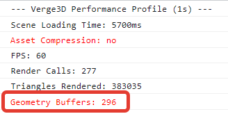

    with absolutely no geometry change or incoming/outgoing objects before
    Are sure? Press P+P+P before and after tweening and compare the count of geometry buffers
