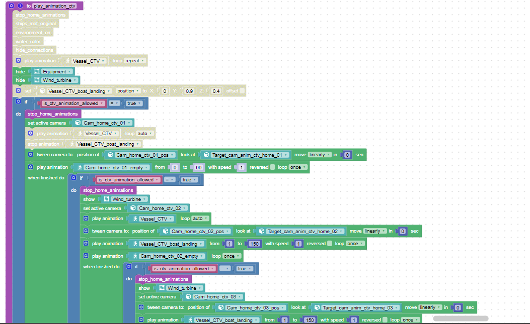

CustomerHi! I created a pretty complicated puzzle structure to play a kind of animation consisting of a few scenes in my app. At some point (at different random moments) the app viewport (the HTML embed section) freezes and cannot be moved/clicked/anything. In the console, I get this error:
Uncaught TypeError: i.toArray is not a function at ya (v3d.js:1:619926) at us.Ya [as setValue] (v3d.js:1:623907) at ms.upload (v3d.js:1:627496) at v3d.js:1:772602 at Fl.renderBufferDirect (v3d.js:1:773736) at We (v3d.js:1:779817) at Qe (v3d.js:1:779430) at ke (v3d.js:1:779007) at Fl.render (v3d.js:1:784271) at Tf.render (v3d.js:1:1076776) ya @ v3d.js:1 Ya @ v3d.js:1 upload @ v3d.js:1 (anonymous) @ v3d.js:1 Fl.renderBufferDirect @ v3d.js:1 We @ v3d.js:1 Qe @ v3d.js:1 ke @ v3d.js:1 Fl.render @ v3d.js:1 render @ v3d.js:1 render @ v3d.js:1 render @ v3d.js:1 (anonymous) @ v3d.js:1 (anonymous) @ v3d.js:1 o @ v3d.js:1 requestAnimationFrame (async) o @ v3d.js:1 requestAnimationFrame (async) o @ v3d.js:1 requestAnimationFrame (async) o @ v3d.js:1 requestAnimationFrame (async) o @ v3d.js:1 requestAnimationFrame (async) o @ v3d.js:1 requestAnimationFrame (async) o @ v3d.js:1 requestAnimationFrame (async) o @ v3d.js:1 requestAnimationFrame (async) o @ v3d.js:1 requestAnimationFrame (async) o @ v3d.js:1 requestAnimationFrame (async) o @ v3d.js:1 requestAnimationFrame (async) o @ v3d.js:1 requestAnimationFrame (async) o @ v3d.js:1 requestAnimationFrame (async) o @ v3d.js:1 requestAnimationFrame (async) o @ v3d.js:1 requestAnimationFrame (async) o @ v3d.js:1 requestAnimationFrame (async) o @ v3d.js:1 requestAnimationFrame (async) o @ v3d.js:1 requestAnimationFrame (async) o @ v3d.js:1 requestAnimationFrame (async) o @ v3d.js:1 requestAnimationFrame (async) o @ v3d.js:1 requestAnimationFrame (async) o @ v3d.js:1 requestAnimationFrame (async) o @ v3d.js:1 requestAnimationFrame (async) o @ v3d.js:1 requestAnimationFrame (async) o @ v3d.js:1 requestAnimationFrame (async) o @ v3d.js:1 requestAnimationFrame (async) o @ v3d.js:1 requestAnimationFrame (async) o @ v3d.js:1 requestAnimationFrame (async) o @ v3d.js:1 requestAnimationFrame (async) o @ v3d.js:1 requestAnimationFrame (async) o @ v3d.js:1 requestAnimationFrame (async) o @ v3d.js:1 requestAnimationFrame (async) o @ v3d.js:1My puzzle structure looks more or less like it is in the picture. I tried to disable all the puzzles and enable them step by step to see when the error appears. I didn’t see any clear pattern maybe besides one thing: is there any limit to the “when finished do” slots we can use in one single puzzle structure tree? I have some hints that this might be the problem here – although I hope it’s something different because the animation sequences made this way work pretty nicely!
Because of the
requestAnimationFrame (async)I also tried to play around with switching on and off the “Advanced playback options” for “play animation” puzzles but it didn’t have any effect.Maybe you have any other clues on what could cause this error?
2023-10-27 at 7:12 pm #67988kdv
ParticipantMy puzzle structure looks more or less like it is in the picture.
Not enough info. Show all of them or upload the app and share the link.
No.

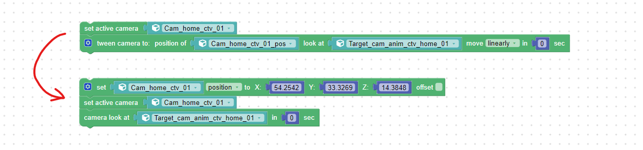

But after hours of testing different enable/disable puzzles in the whole application (it’s really quite big and complex) I eventually came up with a walkaround that seems to work. I figured out that the problem was caused by using a “tween camera” in such a complex puzzle structure – it works fine when I try to recreate it in a blank application but messes up when used in my original complex app.
Anyway, I replaced the “tween camera” puzzles (which come up in a sequence to get the animations to flow one after another, so there are a few of them), with “set position” and “camera look at” puzzles to move the camera to the proper position manually. And this way, it all works.
