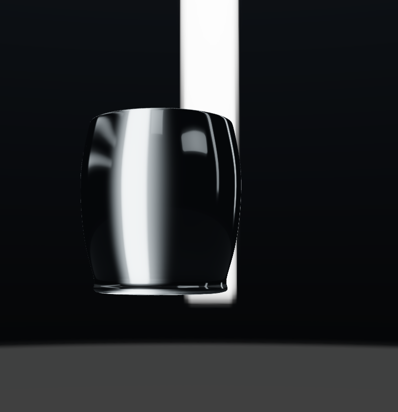

I use the blender essential material lib “thinwall glass”.
Why it looks so bad? How to make good looking glass?Pekka
2022-03-08 at 12:39 pm #50009pekkizz
Customeroh, it should be solid glass :)
But it looks also bad:
Can you tell me what is the problem?
2022-03-09 at 10:19 am #50048
Mikhail LuzyaninStaffYes, thin walled glass still works bad for some meshes, but solid glass must work fine. Can you share this example of wineglass by attaching it here. Just isolate it in the blend file, no need to share all scene.
2022-03-09 at 11:05 am #50052pekkizz
CustomerHere you have it, scene had changed: now its the glass with juice in it.
2022-03-09 at 11:09 am #50054
Mikhail LuzyaninStaffSeems like it’s works fine with solid glass. Does it the same model of wineglass? I think it was something wrong with the previous model.

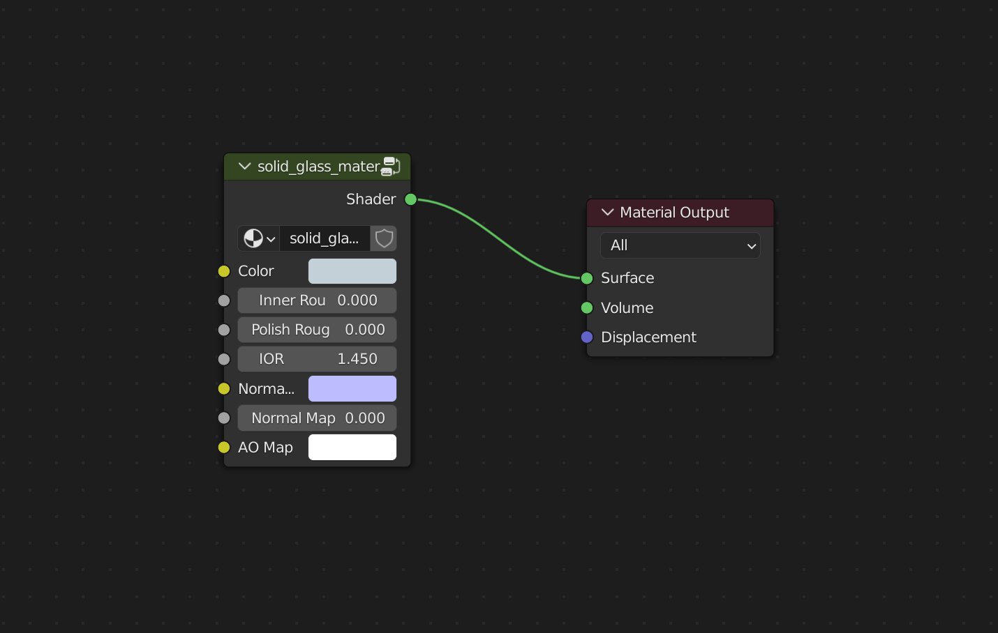

2022-03-09 at 12:08 pm #50064pekkizz
CustomerCool, I might try this.
But where here I add the “refraction on more than 0” or the “refraction node”Please see the attached image
2022-03-09 at 12:12 pm #50066
Mikhail LuzyaninStaffYou do not need to add anything for Solid Glass shader, just assign it and then go to puzzles. I mean if you do not use Solid Glass shader you need to add Refraction manually to your shader that you already have.
