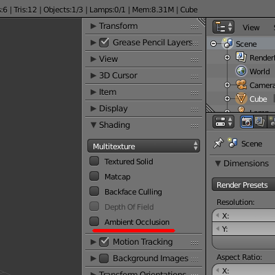

2018-06-01 at 3:11 pm #4556
Ivan LyubovnikovStaffNo, you don’t need to update, it’s in the other panel, they are just named the same for some reason:
2018-06-01 at 3:16 pm #4559
Ivan LyubovnikovStaffit’s the Shading -> Ambient Occlusion option in the Properties Panel
yeah, my bad, I meant the Properties Shelf of course, not the Properties Panel
2018-06-01 at 3:53 pm #4560donalffons
CustomerThank you, Sir! That does the trick.
2018-06-01 at 3:55 pm #4561
Ivan LyubovnikovStaffGlad to hear!
