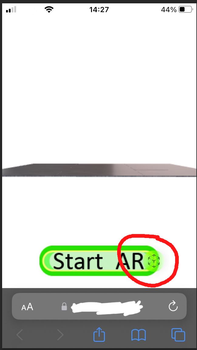

    Hi, I have a cube-frame sitting on my start AR button. It is shown/loaded at the same time as the AR object. Not in AR-mode just now, only loading the app.
    Here is the screenshot.

    That cube is a “logo” that is universal for an AR app/object.
    It means the app/object is AR-capable. You may want to consider repositioning your AR start button. This is a visual cue for your users that they need to enter AR Mode.

    Depends on the iOS version? On my side I do not see that cube image over the AR button in my AR apps or Verge3D AR demo (iOS 15.7).

    Yes, I see the picture in your app. That’s because the link has the “ar” attribute and the “href” attribute is not empty. A kind of a prompt that the link will be opened in the AR Quick Look. The reason is quite simple: your puzzles perform exporting to USDZ right after the app has been loaded. “href” + “ar” = the AR prompt picture over the link. Rework your puzzles to perform exporting on demand and you won’t see that picture anymore. Like here https://v3d.net/9e4
