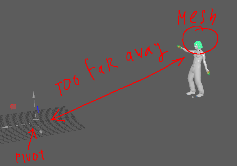

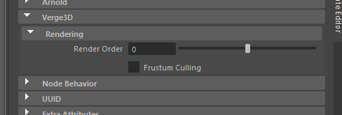

    You need to disable a Frustrum Cullng checkbox on each part of the model that dissapear or keep your animation not so far from object’s pivot.

    I’ve run into the same issue recently (but disabling the Frustrum Culling fixed the problem). When would a person use Frustrum Culling? If this is a common issue (it cropped up on my last couple of projects in progress using V3D v3 with Blender 2.82 but on none before, at least that I noticed), would it not make sense to ship with this setting disabled or am I missing something here?
    This checkbox optimize rendering and works on performans, so if you disable it – this will decrease a rendering speed. It’s only necessery to do if you can’t solve this problem another way like keep your mesh near the pivot.
